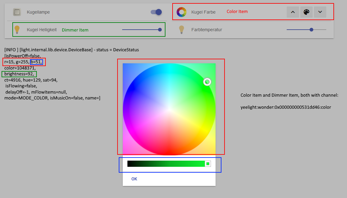

In HabPanel i defined a widget “Colorpicker” (associated with Color-Item) to pick the color and another widget “Slider” also associatet with the Color-Item, so that in can choose color with the colorpicker and can control the brightness of the color with the slider. Then the following occurs:
If i use the colorpicker an choose a color, the light/item will be the color with the choosen brightness. Then if i use the slider to control the brightness, for example to 33, and the light will be at brightness 33. But then the slider or the colorpicker moves automatically to different values. It seems they interact to each other. (But only the widgets, not the item itself)
To make it Clear:
If i choose a color over the color picker with a brightness of 90, the light do what it should to. Then ich choose over the slider a brightness of 20. The light will go on a brightness of 20. But then the slider goes automatically back to that 90 (but the item/light stays at 20). So at this point the slider-value differs from the real value.

It seems that the Sitemap-Colorpicker sends other values (maybe hsb?) than the slider (maybe percenttype?). The Device status show:
status = DeviceStatus [isPowerOff=false, r=14, g=244, b=95, color=980063, brightness=91, ct=3764, hue=141, sat=94, isFlowing=false, delayOff=-1, mFlowItems=null, mode=MODE_COLOR, isMusicOn=false, name=]
If i use the Color-Picker-Slider (under the color ring / Sitemap) the first value changes. (as above b=95)
For me that represents the b in rgb-value, so i dont see a correlation to “brightness”)
If i use the Slider the second value changes. (as above brightness=91)
Both items have the channel “yeelight:wonder:0x000000000531dd46:color”. The first is a color-item and the second a dimmer-item.

I read into HSB-Type before and i think you are right, there is some transformationen problem.
The picture shows it. With the circle in the colorpicker (red) i can control the three rgb-values. With the slider under the colorpicker (blue) i can control the “b”-value.
So with the colorpicker i have no chance to change the brightness-value of that bulb.
With the second item (Dimmer) which creates the slider (green), i can control the brightness value. But then begins the dilemma as described above ;(
The hope is, that there is something i dont understand → there is a solution :wink:
Thank you for your help.
I will try again. When I am using a colorpicker it operates in HSB values, the circle (red in your pic) controls H and S (hue and saturation), the slider underneath controls B (brightness). As you picture shows, you picked green as color and the slider underneath changes the brightness from green (100% to black 0%). If you were to pick the center of the color wheel, the lamp would go white.
By the way the up and down arrow in your sitemap (next to the palette, at the very top right in your pic) will also work as a dimmer. With a short and long press action (on/off vs dimming).
What you have circled on the left are rgb values (where b stands for blue). I am not exactly sure how the yeelight binding is implemented, but I would believe that if your slider below the color wheel does not operate as a dimmer regulating the intensity of whatever color you picked in the color wheel (and the bar will dynamically change color to match the one you picked), you may have found a bug.

Yes i think what you describe is correct. I wonder how other people solved that.
The exception you describe is for yeelight the channel “colorTemperature”, where i can control the white led. The mode-switch is automatic and the channel works as expected.
After your answers i think its something in the binding source code to change, but thats outside my skills :slight_smile:
Hello again,
maybe someone is interested in that simple workaround:
I have unbound the Dimmer Brightness Item from the color channel and wrote a “Workaround-Rule” in which i send Percenttype to the Color Item. That solved the problem.
