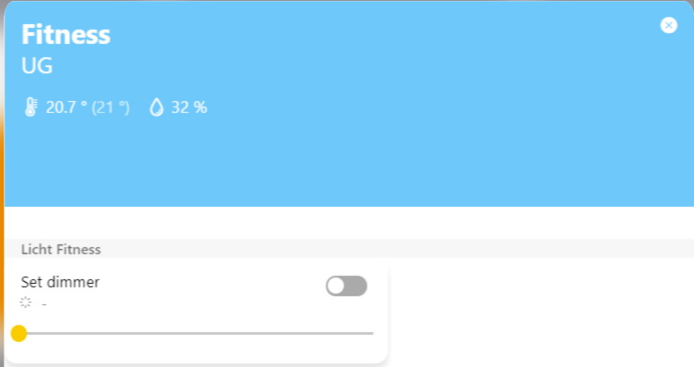

How to use f7-card in a item list representation
For my light dimmers it would be ideal to have a list-widget combining a switch with a dimmer. So I took the f7-card widget developed by aaron2
and integrated it in a list widget via textual item config file:
.... { channel="knx:device:bridge:DALI:UG_Fitness_Licht", listWidget="widget:Dimmer"[Item="UG_Fitness_Licht"]}
on the mobile phone this approach works quite nicely, however on the ipad the card does not fully scale to the max width
does anybody has an idea how that could be done.

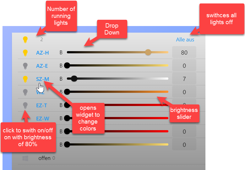

With a lot trial&error and even more help from @RGroll and @JustinG I managed to achieve something similar which I’m quite happy with and whicht might be helpful for you:
The code is not perfect since I’m still an OH-beginner, but it might be interesting anyway:
component: oh-list-card
  noChevron: true
  style:
    background: linear-gradient(to bottom,#e6e6e6 0%,#8c8c8c 100%)
  default:
    - component: f7-list-item
        accordionItem: true
        content:
          - component: f7-row
              class:
                - align-items-center
              style:
                width: 100%
                height: 25px
                flex-wrap: nowrap
              default:
                - component: f7-col
                    class:
                      - display-flex
                      - flex-direction-row
                      - margin-top
                      - margin-bottom
                    style:
                      height: 100%
                      width: fit-content
                      min-width: 100px
                    default:
                      - component: oh-button
                          icon-f7: lightbulb_fill
                          iconColor: '=(items.AnzahlLampenAn.state === "0") ? "gray" : "yellow"'
                          style:
                            --f7-button-bg-color: transparent
                            --f7-button-hover-bg-color: transparent
                            --f7-button-pressed-bg-color: transparent
                      - component: oh-label-item
                          item: AnzahlLampenAn
                - component: f7-col
                    class:
                      - display-flex
                      - justify-content-flex-end
                    style:
                      height: 100%
                      width: 100%
                    default:
                      - component: oh-list-item
                          title: Alle aus
                          action: command
                          listButton: true
                          actionItem: AlleLichterAus
                          actionCommand: ON
        default:
          - component: f7-accordion-content
              default:
                - component: oh-repeater
                    sourceType: array
                    for: devices
                    in:
                      - actionitem: LeuchteHuegross_Farbe
                        label: AZ-H
                      - actionitem: LeuchteHueklein_Farbe
                        label: AZ-E
                      - actionitem: LeuchteMobil_Farbe
                        label: SZ-M
                      - actionitem: LeuchteWohnzimmer_Farbe
                        label: WZ
                      - actionitem: EsszimmerTisch_Farbe
                        label: EZ-T
                      - actionitem: EsszimmerWein_Farbe
                        label: EZ-W
                      - actionitem: EsszimmerKlavier_Farbe
                        label: EZ-K
                      - actionitem: Frosch_Farbe
                        label: EZ-F
                    default:
                          content:
                            - component: f7-row
                                class:
                                style:
                                  width: 100%
                                  height: 25px
                                  flex-wrap: nowrap
                                default:
                                  - component: f7-col
                                      class:
                                        - display-flex
                                        - margin-top
                                        - margin-bottom
                                      style:
                                        height: 100%
                                        width: fit-content
                                        min-width: 100px
                                      default:
                                            action: command
                                            actionItem: =loop.devices.actionitem
                                            actionCommand: '=(items[loop.devices.actionitem].state.split(",")[2] === "0") ?
                                              items[loop.devices.actionitem].state.split(",")[0]+
                                              items[loop.devices.actionitem].state.split(",")[1]
                                              + ",80" :
                                              + ",0"'
                                            iconColor: '=(items[loop.devices.actionitem].state.split(",")[2] === "0") ?
                                              "gray" : "yellow"'
                                            style:
                                            action: popup
                                            actionModal: widget:Widget_farben
                                            actionModalConfig:
                                              leuchte: =loop.devices.actionitem
                                            text: =loop.devices.label
                                            color: blue
                                            style:
                                  - component: f7-col
                                      class:
                                        - display-flex
                                      style:
                                        height: 100%
                                        width: 100%
                                      default:
                                        - component: oh-colorpicker
                                            sliderLabel: true
                                            sliderValue: true
                                            item: =loop.devices.actionitem
                                            modules:
                                              - brightness-slider
Since I don’t know (yet) how to work with variables in OH I exported some values to node-red, where I counted the switched-on-lights and exported it back to OH. But I guess it’s quite simple to do that in OH directly.
