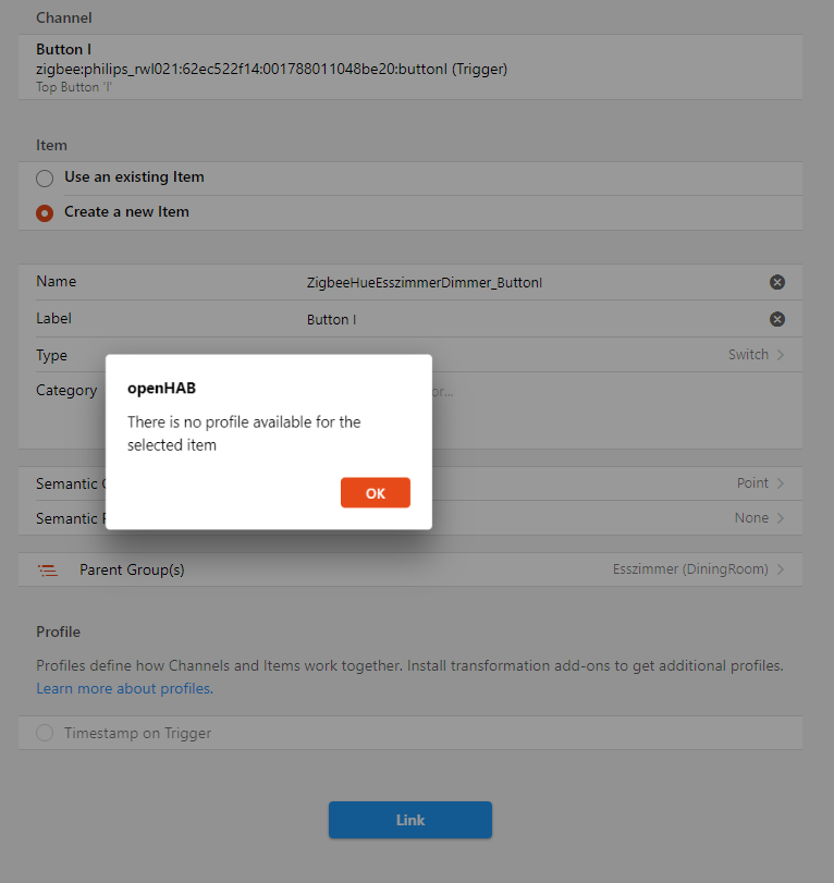

I know that this is a bit muddled but is there an easier way to indicate the relationship of the button press with a list of Equipments?
Because a loose coupling via model is difficult, I cannot link the Button to the model.
BR
/Franz
Alright, I get the gist. You have a bunch of trigger event channels, for each channel you want to find a set of Items via somewhat arbitrary label texts (because that’s one of the the few “free-form” user editable info about a Thing).
It’s going to be an adventure around openHAB and some parts might be a bit clumsy, but go for it :slight_smile:
First clumsy part - there is currently no “channel Group trigger”, so you will have to list individual event channels in your rule trigger.
You’ve already found how to get the current channelUID.
Getting the parent Thing from that is just a string-split job, isn’t it?
Armed with the Thing UID, you’ll need to do this
