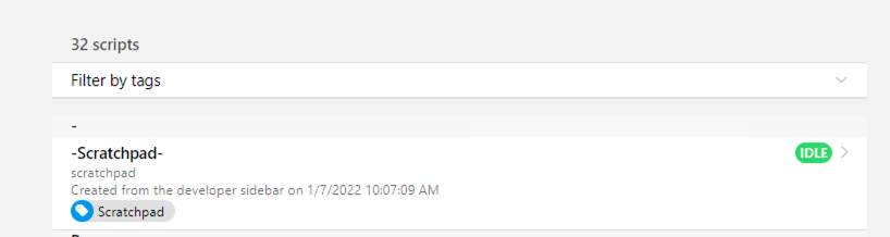

The -Scratchpad- is just a Script. And as documented, a Script in this context is just a special type of rule consisting of a single Script Action without any triggers or conditions.
Is that how you would print out all the Things in a regular rule?
Did you save it before trying to run it? What version of OH are you on. Versions prior to OH 4.2 M2 do not automatically save when you hit the run button.
“did not work” encompasses almost an infinity. Doesn’t work how? Errors in the log? It’s not clear, are you even looking at the logs? That’s where console.log is going to print.
There is nothing special about -Scratchpad-. It’s a Script like any other. In fact you can find it under Settings → Scripts.
Because it starts with “-”, it’s always at the top of the list.
