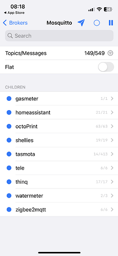

Using a tool like MqttAnalyzer on iPhone and subscribing to „#“ should show something like this
I got no iPhone, but i tested with an app under android, result is the same as in mosquitto_sub.
Can you please show what you get on your phone (screenshot)
Did you make the IP changes in the files and restart mosquitto and OH?
I guess not, so we are still trying to solve an issue not openHAB related ![]()

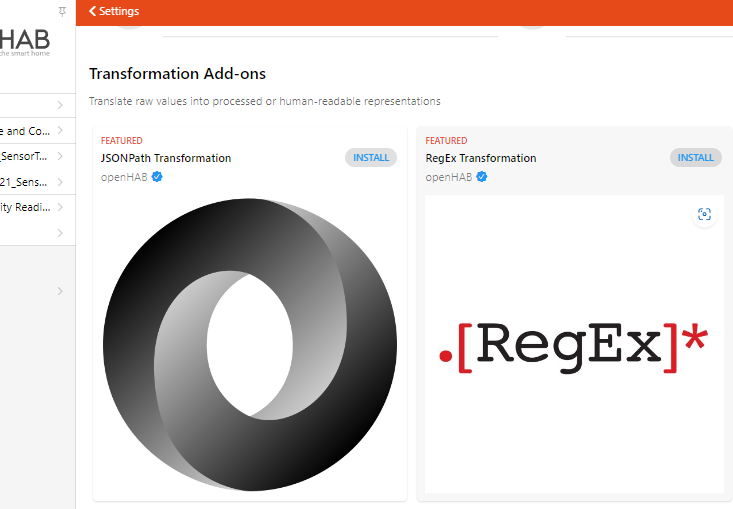

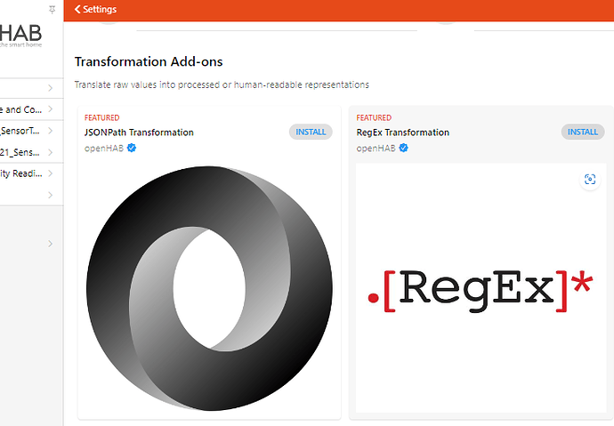

→ Incoming value Transformation is set to: JSONPATH:$.contact
→ i think transformation is missing, but i only see DSL?!
I hate to get involved here as I haven’t read everything, but you did install the transformations you are trying to use?
Hi thanks, i did find it and installed it. But the value is still N/A. Do i have to configure the Add-On?
