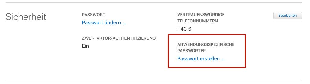

  1. Log into your Apple-ID at appleid.apple.com ( not www.icloud.com! ) . Confirm your login by entering the two-factor identification code sent. Once logged in, look for the section in your Apple ID control panel labeled “Security” and click on “Generate Password”
  1. When prompted, label the app-specific password whatever you want eg “OpenHab” and click “Create”.
  2. Apple will provide you with a randomly generated alphanumeric string in the format xxx-xxxx-xxxx-xxxx. Highlight and copy the password and keep it somewhere safe.
