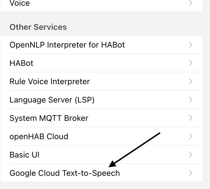

Hey, I’m using OpenHab 3.1 and can’t figure out where to insert the google API credentials (secret and clientId). I saw that in OH3, PaperUI no longer exists. Is there an alternative to inserting the credentials?
Thanks.
The docs say it’s under Settings → Other Services.
Yes, it was indeed there BUT only after I was able to successfully verify my credentials over the web. Entering this URL: https://accounts.google.com/o/oauth2/auth?client_id={clientID}&redirect_uri=urn:ietf:wg:oauth:2.0:oob&scope=https://www.googleapis.com/auth/cloud-platform&response_type=code
and replacing {clientID} with your clientId was crucial for the process to work. Also, while defining google APIs credentials, I re-created it and made sure my scope was set to https://www.googleapis.com/auth/cloud-platform and my users to the user I’m about to log-in and verify the account from.
