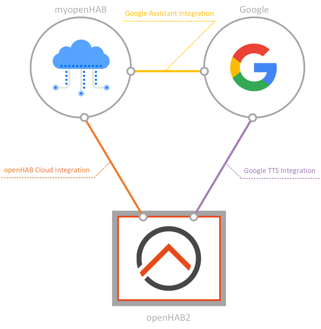

1.1 How does it work?
How does it work?
Your openHAB2 system will create 2 connections:
  1. To myopenHAB.org Cloud Service to allow remote (voice) control using Google Assistant
  2. To Google’s Cloud to send text and receive audio

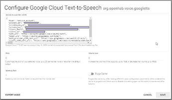

2.2.3 Configure Google TTS Add-on under PaperUI → Configuration → Services → Voice as follows:

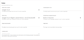

2.2.4 Configure the Voice settings under PaperUI → Configuration → System → Voice as follows:

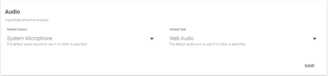

2.2.5 Configure the Default Sink to be Web Audio under PaperUI → Configuration → System → Audio
