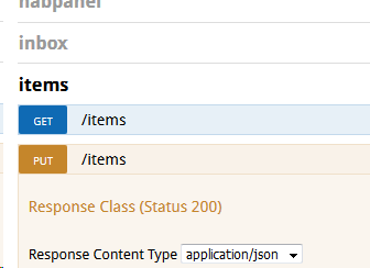

If that works, you can for example in step 7 go to PUT/items
Thank you, yes your scripts worked properly, I was just uncertain about that step 7, because that link doesnt work. Im able to go to PUT /items, manualy, so I going to try it.

You can try with just one item to see you get a response 200 OK. Do that before you start deleting things. You will get OK even if the item already exist. Remember starting/ending .

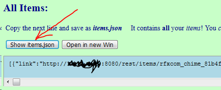

hello i tried typing linksAdd in ssh console but this command doesnt exit . Any help would be appreciated
Hi, linksAdd is not a command, it’s a button saying Show linksAdd.txt, or click Open in new Window. Paste that into SSH, i. e. curl -X PUT --header "Content…
If you managed steps 4 & 5, then step 8 works the same way…
