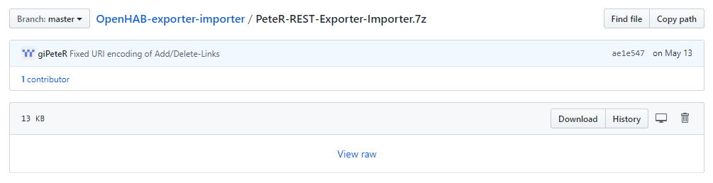

I’ve tried the .7z file from here GitHub - giPeteR/OpenHAB-exporter-importer: OpenHAB REST Export/Import for Items and Links then i get an error “Is not archive” when trying to extract
When I click on the file name, I get this
then I get the download button to get the download link and use it on my linux PC (ssh) to download the file
sudo wget https://github.com/giPeteR/OpenHAB-exporter-importer/raw/master/PeteR-REST-Exporter-Importer.7z

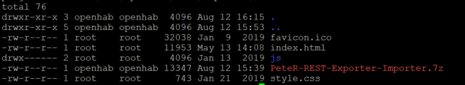

Ok, I see what you mean. The exporter directory is not in the zip. Here’s how to make it work:
mkdir /tmp/exporter
7za x PeteR-REST-Exporter-Importer.7z -o/tmp/exporter
sudo chown -R openhab:openhab /tmp/exporter
sudo mv /tmp/exporter $OPENHAB_CONF/html/
Open your browser and go to http://<openhabip>:8080/static/exporter
You will now see the instruction page.

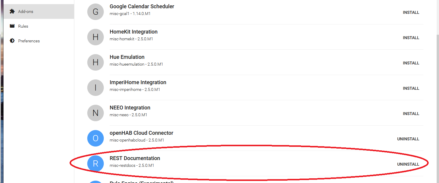

Hi - the problem with step 7, where http://openhabianpi:8080/doc/#!/items/createOrUpdateItems can’t be accessed is because some of you guys don’t have the rest documentation addon installed in paperUI. Attached is an image where you can find the rest doc addon.
After this addon is installed, you’ll be able to access http://openhabianpi:8080/doc/#!/items/createOrUpdateItems
