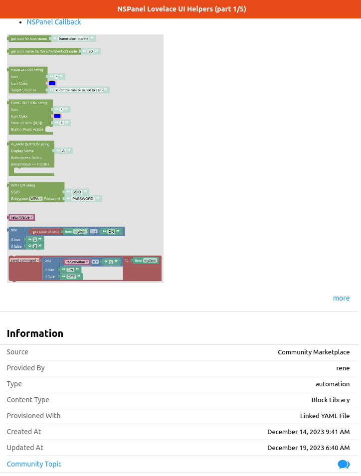

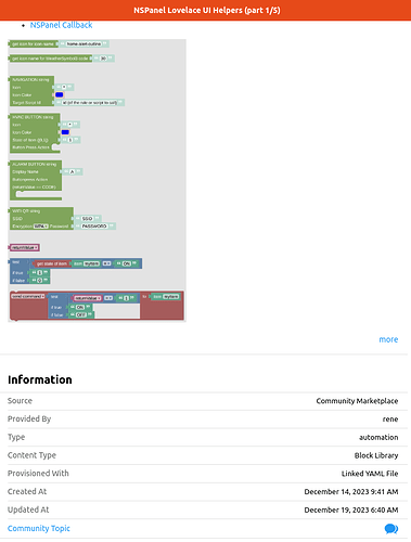

That certainly didn’t used to be the case. In my experience, edits to the marketplace topics get picked up and propagated to the marketplace fairly quickly.
When I look at an entry in my add-on block library section (e.g. your part 1/5) it looks entirely correct. It matches the version on the forum and links to a 0.3 release page not the main branch of your repo.
Are you by chance using firefox? This could be another symptom of the firefox page caching issues that are becoming very common.

Strange. It’s definitely local to your system, whatever it is. Mine shows the correct edit date as well as the updates themselves.
