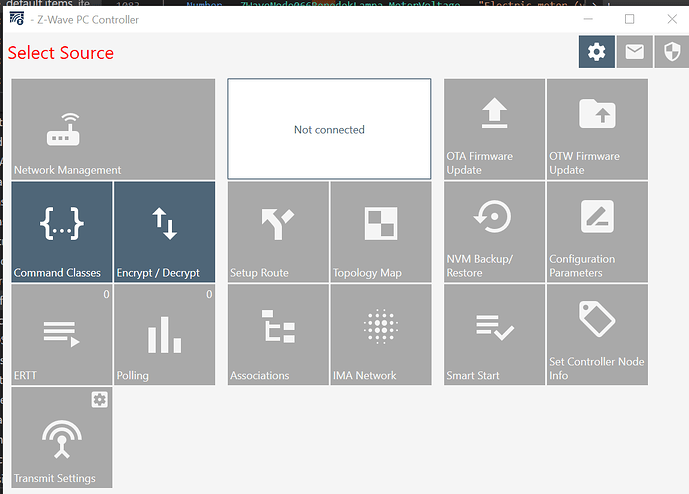

It is impossible (or nearly so- maybe this Zway app works, but I don’t have that setup) to remove a broken battery sensor from OH without the Silabs tool and the Razberry module (you cannot hook it up to a PC USB port -AFAIK).
To remove a failed node there is a two-step process. First is to “set device as failed (OH)” or “check if failed” (Silabs PC controller). The key difference between OH and the Silabs PC controller is that OH will not send a message to a node it considers sleeping, so it does not get marked as failed. The Silabs PC controller will mark a sleeping node as failed (even if it not!) (Since it did not respond-It is sleeping!) and then you can send the “replace failed”.
I happen to generally like Zwave and OH, so I would suggest that if you have access to a windows machine, it might be cheaper to buy a USB Zwave dongle for the Pi, depending on the size of the network (IMHO). If you don’t have a windows machine, it is probably best to ditch zwave since all the Silabs tools are PC based.
