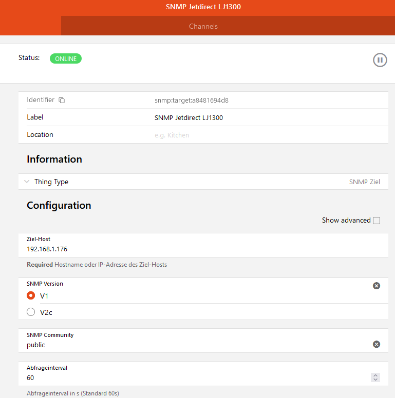

Thanks - where do I configure the “channels” thingy? I am new to OpenHAB. Is this a file somewhere in the OpenHAB filesystem?
GUI:
Install SNMP Binding first, then:
Settings → Things → press blue [+] button → SNMP Binding → SNMP Target → configure hostname → Create Thing → Select the new Thing from the list of all Things → Channels → Add channel (OIDs correspond to Channels of the Thing) - don’t forget to save your changes.
