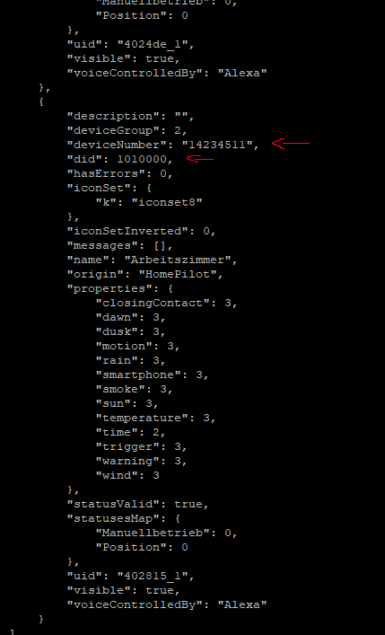

your “did” and" device number" look very different to my one’s. Can you run the script with additional parameter -f to get the full configuration of HomePilot and post it here? Or send it via PM?
You will find it in data/device_info.json directory but you must run it without docker.
Another option (maybe easier): You can also browse homepilot with your web browser to get it: http://[Your HomePilot IP address]/v4/devices
Please make sure to gather the right parameters:
Hi pduck27, will share via PM. If we got some more clue, why my Pid is different we can share here…
