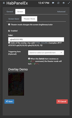

It seems to work on my PC and Android phone, but the widget doesn’t seem to want the load in safari, Firefox, or chrome on my iPad 4 on iOS 10.3.3 for some reason, probably some stupid restriction apple put into place. Has anyone else been able to get it to work on iPad?

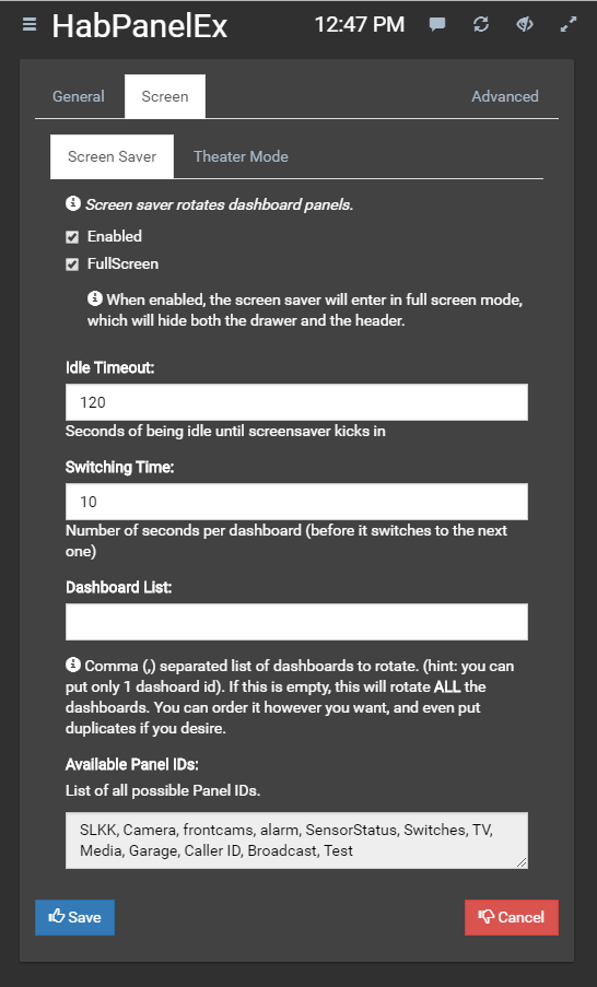

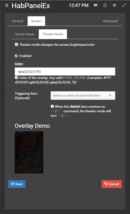

I just tried on Safari
(sorry about the phone photo, it’s a work macbook pro :slight_smile: )
Ok…so, I just went to 2.5 snapshot for issues with mqtt 2.x binding and now the widget is correct…
But, it never goes to the specified dashboard after 30 seconds.
And the Available Panel ID’s is wrong, and doesn’t list the current panel.

The IDs are not the panel name. It is taken from the list of Habpanel itself. Also, the ā€œcurrentā€ panel is not shown because I exclude habpanelex from it. We dont want the settings be part of the rotation.

It seems to have fixed my iPad issue, but i’m using the Matrix theme from Matrix Theme for HABPanel and theater mode doesn’t seem to work on any dashboards but the hpex setup screen. It’s a css conflict somewhere for sure, because if I take the external css file out of my habpanel config theater mode works as expected - just need to figure out where.
