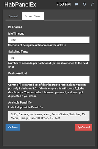

Current Feature
  1. Toggable Drawer item
  2. Screen Saver
  3. Theater Mode
  4. Multi device Configuration

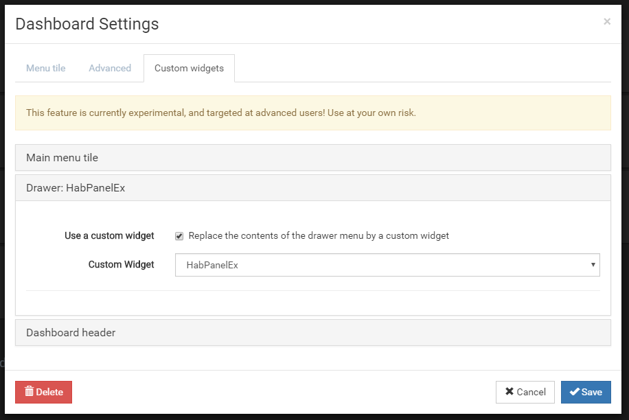

  3. Go To Main Dashboard
  4. Add New Dashboard
  5. Name it HabPanelEx (A MUST)
  6. Go to that Panel (HabPanelEx)
  7. Add a widget and pick HabPanelEx
  8. Go back to main dashboard and edit
  9. Click Gear Icon (settings) for HabPanelEx
  10. Configure as shown on photo
  11. Go to the HabPanelEx panel (click it from drawer)
  12. Add Widget, select HabPanelEx then Save. Run
  13. Click on HabPanelEx from Drawer and Configure.

Does this have all the screensaver features from your previous go (but with a simplified approach to panel selection)?
I actually made it simpler. You just type in the list of panel IDs you want. If there’s demand to simple drag/drop, I can do that too. This is still a wip. I might remove the widgetgallery tag for the mean time

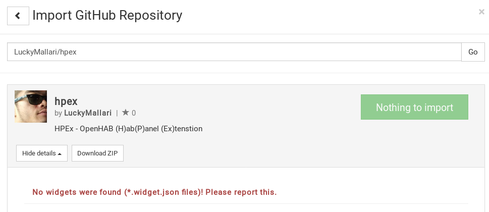

I’m sure it’s because I’m just blindly following instructions…but, when I go to import the widget:
Import the widget.json file you directly downloaded from the repo. I am removing the tag for now so it doesn’t show up in widget gallery since this is in WIP status still.

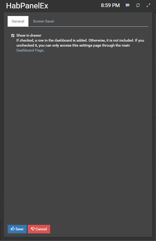

Ok, stuck on step 10, I get nothing about Configure.
Same here.
Blank widget

No joy for me. Step 13. no General or Screen Saver tabs.
