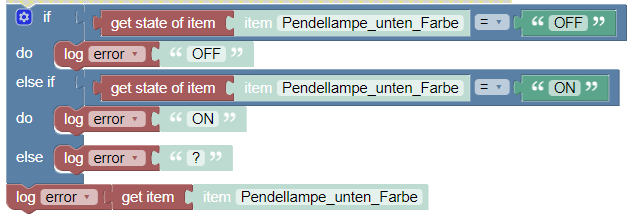

Hello all,
i am using a HUE light with the available channels Color, Color_Temperature, Color_Temperature_abs, Alert and Effect.
No ON/OFF switch or brithness channel is available.
Now i want to check if my light is ON or OFF in a Blockly rule. But i am not able to do that.
In the state i am getting the HSB values. Can i somehow check the brithness (last value)? Or is there a better way?
2023-06-13 12:30:49.988 [ERROR] [org.openhab.rule.47c6897712 ] - ?
2023-06-13 12:30:50.004 [ERROR] [org.openhab.rule.47c6897712 ] - Pendellampe_unten_Farbe (Type=ColorItem, State=46,49,0, Label=Pendellampe unten , Category=ColorLight, Tags=[Control, Light], Groups=[Pendellampe_unten])
Thank you
