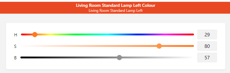

How does the item look in the main UI (e.g. below)? Do you have valid values for all three HSB elements (H=0..360, S=0..100, B=0..100)?
And to be more specific, if you use an external manual control of the lamp, do the respective values move on the UI? If any of the values are ‘stuck’ this tells you that the problem arises from how the channel reads your data from MQTT..
Hmm. I would nevertheless advise you to use one item per channel, at least until the issue is resolved.
