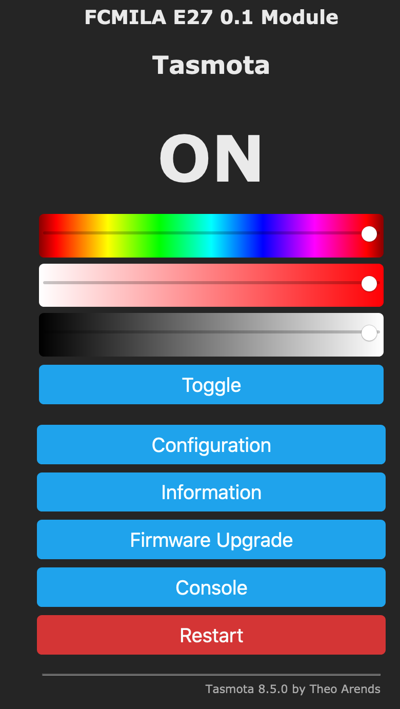

Via Tasmota’s web interface I set color to red with full saturation and brightness.
The corresponding log looks like this:
2020-10-21 15:12:13.923 [vent.ItemStateChangedEvent] - BTL_bulb_1_color changed from 359,63,100 to 359,100,100

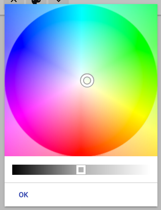

When I open the colorpicker after an reload, it shows correct values:
After changing the color 1 or multiple times, brightness jumps to 50%.
The log does not give any hints in this:
2020-10-21 15:17:01.278 [ome.event.ItemCommandEvent] - Item ‘BTL_bulb_1_color’ received command 238,92,100
2020-10-21 15:17:01.327 [vent.ItemStateChangedEvent] - BTL_bulb_1_color changed from 359,100,100 to 238,92,100

Additionally, when the colorpicker is closed and opened again, it shows a white color:
Closing the colorpicker and reloading the page solves this issue.
