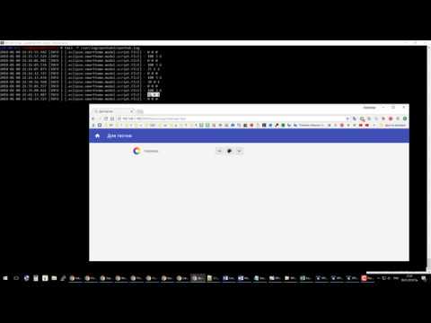

In colorpicker in GUI on web page or android app I set color value “25 0 1”
If I click on “OFF” button - OH write “0 0 0”
If I click on “ON” button - OH write “100 3 6”
Why?
  1. Why brightness sets in 100%?
  2. Why another values changing? But this point not very important
I think you log to different Value’s …
By Clicking ON you log RGB…
By Clicking OFF the HUE SAT BRI logged …
Can someone help me to find the answer and thesolution?
I doubt that everyone likes the fact that the value of color varies by itself on 255,255,255
This are Color (RGB) Values …
HSB Values is HUE SAT BRI not R G B
And how should I act? What should I do?
I want that brightness to be restored to the specified value.
I change RGB value trought the colorpicker. I push OFF button, then push ON button. And brightness dont restore
