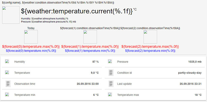

I tried with example, but still it isn’t working. I think I have problem with file location. Can you describe where do you have your weather files ? and what is the trick with webapps/weather-data directory ? I have created webapps/weather-data directory in openHAB2/userdata but I have not got any result. My webapps/weather-data directory is empty, maybe this is a reason ? I have all my layout files in openHAB/conf/html directory (.html, .js, css, .png).
That would be a problem.
I copied the layouts and images directory to openhab/userdata/webapps/weather-data and still don’t have value in html layout. Ufff !
he Gieemek, look at your items in the karaf console by typing items list
Then check if your temp, humidity, etc… items have some value
Yes, items have values. I can see them in karaf console and in the sitemap. They change for each 5 min (duration time), so the weather binding works. HTML layout is shown at sitemap. Only problem I have that html layout is not show values, as like Jaghova at the bigining of this topic.
This is image of my sitemap :
HTML page is example from Weather Binding page, so should work.
I have created directories openhab/userdata/webapps/weather-data with files as described at Weather Binding page and as namraccr wrote.
I really don’t know where is my mistake.
Thanks everybody for help.
Below I put all my files containing with weather binding - mayby somebodywill find my stupid mistake:

I use openHAB 2 beta4 with Weather Binding 1.9.0.b4. Weather and HTTP bindings are installed only.
It’s due to the difference in how openHAB2 delivers static content.
  1. First, edit weather.html (or example.html by default) so that all directories start with “static/” e.g.
<link rel="stylesheet" type="text/css" href="static/weather-data/layouts/example.css" />
  1. You need move dynamic html files to a place where openHAB can handle the webapp content:
  • If you’re using MANUAL Installation: Move your /weather-data/layouts/weather.html folders and file to /opt/openhab2/userdata/webapps
  • If you’re using AUTOMATIC Installation (e.g. apt-get): Move them to /var/lib/openhab2/webapps
  1. Change your sitemap to the following (You can change the values set for locationId=, layout=* and iconset=***):
Webview url="/weather?locationId=home-HAM&layout=weather&iconset=colorful" height=20
  1. Finally, make sure the static content (the /weather-data/ folder) is in your html folder:
  • If you’re using MANUAL Installation: /opt/openhab2/conf/html
  • If you’re using AUTOMATIC Installation (e.g. apt-get): /etc/openhab2/html
Thanks a lot Benjy, it working and I have correct item value at html layout.

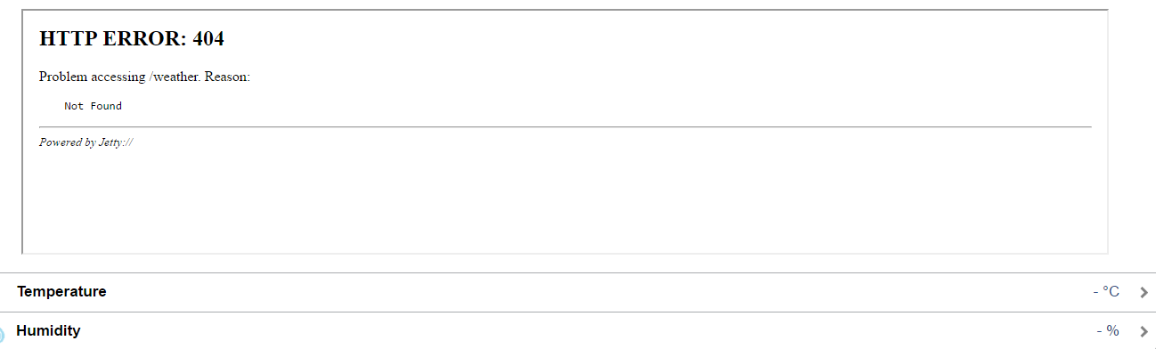

For me it doesn’t work. Here is the output:
my .sitemap:
Webview url=“/weather?locationId=home&layout=example&iconset=colorful”
my folder structure:
  1. /etc/openhab2/html => one folder called weather-data. Inside it contains 2 sub-folders images and layouts. And ofcourse the latter has example.html, example.css, example.js
    The content of .html file:

And it still shows nothing! I’m quite disappointed, maybe I did some silly error but I couldn’t figure out, can anyone help me?
Hi @Nguy_n_Phuc_Anh_D_ng, see my post above:
Particularly moving the /weather-data/layouts/weather.html folders and file to inside the userdata/webapps folder.
I did make a copy of weather-data folder and put it under the path /var/lib.openhab2/webapps (because I’m using package installation so there’s no userdata/webapps link)

That’s what I did! Here are the pictures:
example.html:
<!DOCTYPE html>
<html>
<head>
	<meta http-equiv="Content-type" CONTENT="text/html; charset=utf-8">
	<script type="text/javascript" src="static/weather-data/layouts/example.js"></script>
</head>
<body id="weather-body" onload="formatIframe()">
	<div id="weather-location-name">${config:name}, ${weather:condition.observationTime(%1$td.%1$tm.%1$tY %1$tH:%1$tM)}</div>
	<table id="weather-table">
		<tr>
			<td rowspan="2"><img id="weather-icon" src="static/weather-data/images/${param:iconset}/${weather:condition.commonId}.png"/></td>
			<td id="weather-temp">${weather:temperature.current(%.1f)}</td>
			<td id="weather-temp-sign">°C</td>
		</tr>
		<tr>
			<td colspan="2">
				<table id="weather-table-details">
					<tr>
						<td>Humidity:</td>
						<td>${weather:atmosphere.humidity} %</td>
					</tr>
					<tr>
						<td>Pressure:</td>
						<td>${weather:atmosphere.pressure(%.1f)} mb</td>
					</tr>
				</table>
			</td>
		</tr>
	</table>
	<table id="weather-forecast-table">
		<tr>
			<td>Today</td>
			<td>${forecast(1):condition.observationTime(%1$tA)}</td>
			<td>${forecast(2):condition.observationTime(%1$tA)}</td>
		</tr>
		<tr>
			<td><img src="static/weather-data/images/${param:iconset}/${forecast(0):condition.commonId}.png"/></td>
			<td><img src="static/weather-data/images/${param:iconset}/${forecast(1):condition.commonId}.png"/></td>
			<td><img src="static/weather-data/images/${param:iconset}/${forecast(2):condition.commonId}.png"/></td>
		</tr>
		<tr>
			<td class="temp-max">${forecast(0):temperature.max(%.0f)}</td>
			<td class="temp-max">${forecast(1):temperature.max(%.0f)}</td>
			<td class="temp-max">${forecast(2):temperature.max(%.0f)}</td>
		</tr>
		<tr>
			<td class="temp-min">${forecast(0):temperature.min(%.0f)}</td>
			<td class="temp-min">${forecast(1):temperature.min(%.0f)}</td>
			<td class="temp-min">${forecast(2):temperature.min(%.0f)}</td>
		</tr>
	</table>
</body>
</html>
.sitemap:
Webview url=“/weather?locationId=home&layout=example&iconset=colorful” height=7
but no progress is shown :frowning:
My fault, I’m sorry!
The “example.html” is under “/var/lib/ openhab2 /weather-data/layouts”
I updated my post above.
OK, I changed the directory structure as you said but still no luck:
.html file:
<!DOCTYPE html>
<html>
<head>
</head>
		<tr>
		</tr>
		<tr>
			<td colspan="2">
					<tr>
						<td>Humidity:</td>
					</tr>
					<tr>
						<td>Pressure:</td>
					</tr>
				</table>
			</td>
		</tr>
	</table>
		<tr>
			<td>Today</td>
		</tr>
		<tr>
		</tr>
		<tr>
		</tr>
		<tr>
		</tr>
	</table>
</body>
</html>
.sitemap:
Anyway thanks for your quick reply!
