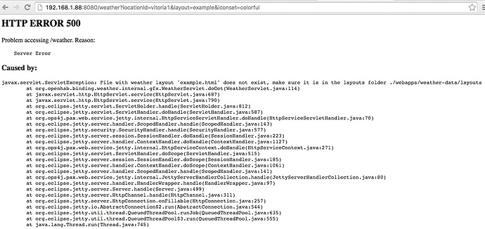

I get the error about the layout file not being found:
HTTP ERROR 500
Problem accessing /weather. Reason:
Server Error
Caused by:
javax.servlet.ServletException: File with weather layout ‘example.html’ does not exist, make sure it is in the layouts folder ./webapps/weather-data/layouts
at org.openhab.binding.weather.internal.gfx.WeatherServlet.doGet(WeatherServlet.java:114)
at javax.servlet.http.HttpServlet.service(HttpServlet.java:687)
at javax.servlet.http.HttpServlet.service(HttpServlet.java:790)
at org.eclipse.jetty.servlet.ServletHolder.handle(ServletHolder.java:812)
at org.eclipse.jetty.servlet.ServletHandler.doHandle(ServletHandler.java:587)
at org.ops4j.pax.web.service.jetty.internal.HttpServiceServletHandler.doHandle(HttpServiceServletHandler.java:70)
at org.eclipse.jetty.server.handler.ScopedHandler.handle(ScopedHandler.java:143)
at org.eclipse.jetty.security.SecurityHandler.handle(SecurityHandler.java:577)
at org.eclipse.jetty.server.session.SessionHandler.doHandle(SessionHandler.java:223)
at org.eclipse.jetty.server.handler.ContextHandler.doHandle(ContextHandler.java:1127)
at org.ops4j.pax.web.service.jetty.internal.HttpServiceContext.doHandle(HttpServiceContext.java:271)
at org.eclipse.jetty.servlet.ServletHandler.doScope(ServletHandler.java:515)
at org.eclipse.jetty.server.session.SessionHandler.doScope(SessionHandler.java:185)
at org.eclipse.jetty.server.handler.ContextHandler.doScope(ContextHandler.java:1061)
at org.eclipse.jetty.server.handler.ScopedHandler.handle(ScopedHandler.java:141)
at org.ops4j.pax.web.service.jetty.internal.JettyServerHandlerCollection.handle(JettyServerHandlerCollection.java:80)
at org.eclipse.jetty.server.handler.HandlerWrapper.handle(HandlerWrapper.java:97)
at org.eclipse.jetty.server.Server.handle(Server.java:499)
at org.eclipse.jetty.server.HttpChannel.handle(HttpChannel.java:311)
at org.eclipse.jetty.server.HttpConnection.onFillable(HttpConnection.java:257)
at org.eclipse.jetty.io.AbstractConnection$2.run(AbstractConnection.java:544)
at org.eclipse.jetty.util.thread.QueuedThreadPool.runJob(QueuedThreadPool.java:635)
at org.eclipse.jetty.util.thread.QueuedThreadPool$3.run(QueuedThreadPool.java:555)
at java.lang.Thread.run(Thread.java:745)
Powered by Jetty://

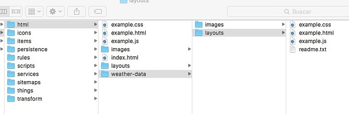

Here comes my try:
Just to be sure I copied the folders under /html/ and under /html/weather-data/

The binding says that the “example.html” file can not be found on /webapp/weather-data/layout (which is the old path for OH 1.8)

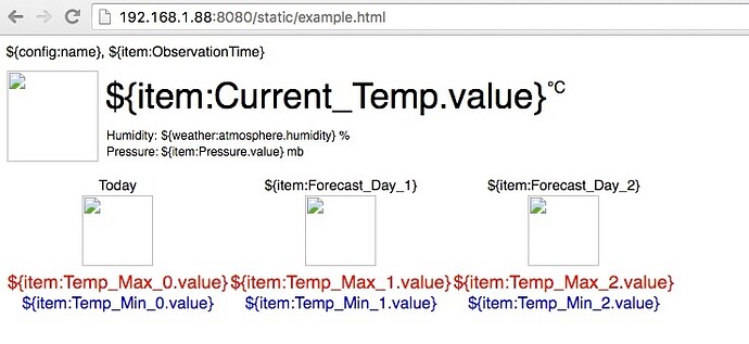

I tried what @pahansen wrote using the following ulr:
http://192.168.1.88:8080/static/example.html
And this is what I get:
I can display the “example.html” but is not bound to any information.

As far as i can see, the content is just static HTML, it does not replace dynamic content.
I experimented with this tonight and found that placing a “webapps” directory containing the “weather-data” directory under userdata gets the right weather values populating. eg.
%openhabhome%/userdata/webapps/weather-data/
The images aren’t being loaded, however. I guess that could be a proxy problem in OH2 ?
So, it turns out you can fix the image problems by dropping all the static content off in the conf/html directory and update the layout file with the correct paths:
/static/weather-data/layouts/example.css
/static/weather-data/layouts/example.js
/static/weather-data/images/${param:iconset}/${forecast(0):condition.commonId}.png
etc…
