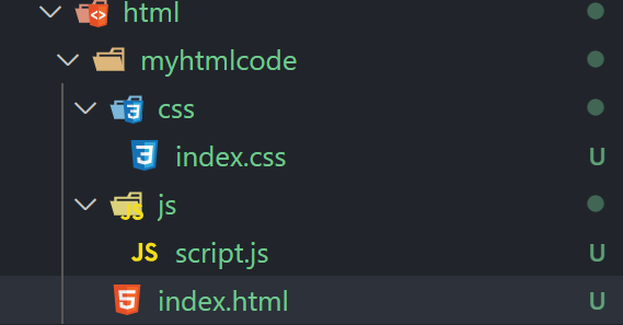

Is it possible that this file structure is not working
I include je css en js file as follows
  <link rel="stylesheet" href="css/index.css">
  <script src="js/script.js"></script>
Not sure why but the script.js file is not processed. The file index.css is working. I found that a change to the file structure is solving the issue but I don’t understand why
  <script src="script.js"></script>
The only way I can the script working is to put it in the html file. Why is this not working in a separate file?
