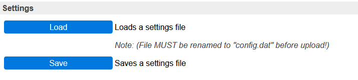

When you say configuration file are you talking about the config.dat file that can be downloaded from the ESPEasy? Or is that a OpenHAB config file?
Sorry, I mixed up ESPEasy and ESPHome :flushed:
Maybe you can find the info for ESPEasy here:
Sorry for the confusion

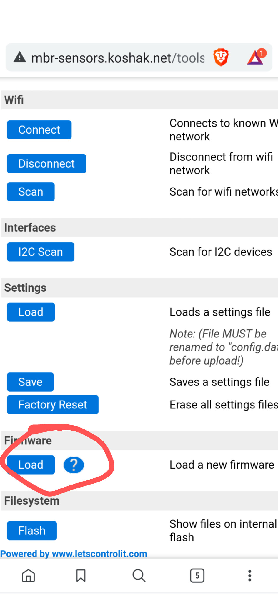

Maybe I’m mistaken but ESPEasy she’s OTA updates too. I know I’ve updated mine without needing to plug them in to a computer.
Though you need to manually download the update to your machine running the browser. Maybe that’s what you are referring to?
Oh man, my knowledge of ESPEasy is less than nothing :blush:
I should stop making statements about functionalities I did not use by myself. :crazy_face:
Thank you for clarifying, Rich.
