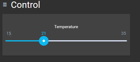

I have simple HTTP binding for retrieving setting of current temperature. I’m using slider to show and manipulute the value itself. For sending the settings back to heatpumg I’m using simple rule (not configured in .items file as I need to set up auth and send json data.)

The rule itself is working fine (I can see the actual temperature has been set). Unfortunatelly after few seconds the slider changes its possition back to original one.
I can see it also in event.logs.
[ome.event.ItemCommandEvent] - Item 'SH_Tcomfort' received command 22 -> I changed the slider to 22
[vent.ItemStateChangedEvent] - SH_Tcomfort changed from 21 to 22 -> My change caused slider to change
[vent.ItemStateChangedEvent] - SH_Tcomfort changed from 22 to 21 -> who the hack sends this update?
The question is why the slider reverts back to previous state? Does it something to do with HTTP cache I set up in /etc/openhab2/services/http.conf ? If yes, how to solve the issue? If not, what am I missing.
