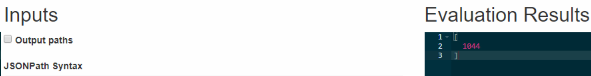

The JSON is quite big and via JSON-path statements I succeeded in getting the right values (tested this with http://jsonpath.com/, it returns the value I want between square brackets
