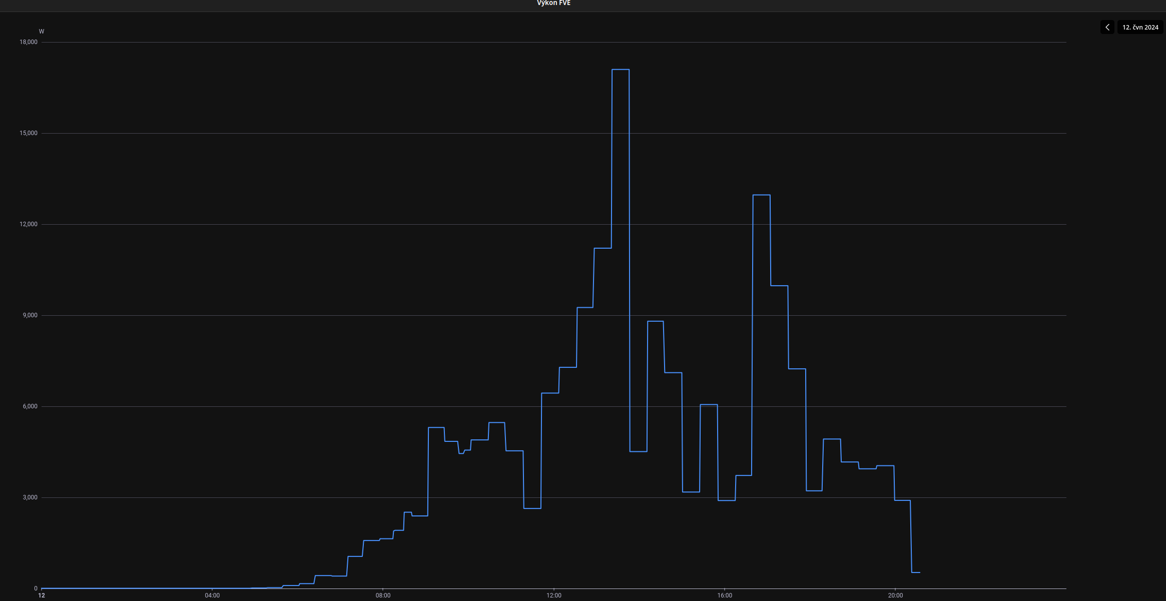

it seems to me that after OH restart, the HTTP binding refresh interval extends itself until the thing valued does not change at all (after 4 or 5 days).
The refresh interval is set 5 seconds and few hours after restart it really gets updated that often:
screen-restart
On the second day the refresh interval seems to be already 5 minutes or so:
day-2
Third day 20 minutes:
day-3
I can see this behaviour on more than one thing a it does not matter if I use oh-http binding or SmartHomeJ http binding. Turning debuggin on has not provided me any hints sofar. Having to periadically resatart OH is very annoying, I would appreciate any hints on what might be wrong.

2024-06-10 18:50:22.169 [DEBUG] [ing.http.internal.HttpHandlerFactory] - bundle org.openhab.binding.http:4.1.2 (292)[org.openhab.binding.http.internal.HttpHandlerFactory(347)] : Querying state unsatisfiedReference
2024-06-10 18:50:22.171 [DEBUG] [ing.http.internal.HttpHandlerFactory] - bundle org.openhab.binding.http:4.1.2 (292)[org.openhab.binding.http.internal.HttpHandlerFactory(347)] : Changed state from unsatisfiedReference to satisfied
2024-06-10 18:50:22.172 [DEBUG] [ing.http.internal.HttpHandlerFactory] - bundle org.openhab.binding.http:4.1.2 (292)[org.openhab.binding.http.internal.HttpHandlerFactory(347)] : registration change queue [registered]
2024-06-10 18:50:22.184 [DEBUG] [ing.http.internal.HttpHandlerFactory] - bundle org.openhab.binding.http:4.1.2 (292)[org.openhab.binding.http.internal.HttpHandlerFactory(347)] : Checking constructor public org.openhab.binding.http.internal.HttpHandlerFactory(org.openhab.core.io.net.http.HttpClientFactory,org.openhab.binding.http.internal.HttpDynamicStateDescriptionProvider)
2024-06-10 18:50:22.186 [DEBUG] [ing.http.internal.HttpHandlerFactory] - bundle org.openhab.binding.http:4.1.2 (292)[org.openhab.binding.http.internal.HttpHandlerFactory(347)] : getClassFromComponentClassLoader: Looking for interface class org.openhab.core.io.net.http.HttpClientFactory through loader of org.openhab.binding.http.internal.HttpHandlerFactory
2024-06-10 18:50:22.188 [DEBUG] [ing.http.internal.HttpHandlerFactory] - bundle org.openhab.binding.http:4.1.2 (292)[org.openhab.binding.http.internal.HttpHandlerFactory(347)] : getClassFromComponentClassLoader: Found class org.openhab.core.io.net.http.HttpClientFactory
2024-06-10 18:50:22.190 [DEBUG] [ing.http.internal.HttpHandlerFactory] - bundle org.openhab.binding.http:4.1.2 (292)[org.openhab.binding.http.internal.HttpHandlerFactory(347)] : getClassFromComponentClassLoader: Looking for interface class org.openhab.binding.http.internal.HttpDynamicStateDescriptionProvider through loader of org.openhab.binding.http.internal.HttpHandlerFactory
2024-06-10 18:50:22.192 [DEBUG] [ing.http.internal.HttpHandlerFactory] - bundle org.openhab.binding.http:4.1.2 (292)[org.openhab.binding.http.internal.HttpHandlerFactory(347)] : getClassFromComponentClassLoader: Found class org.openhab.binding.http.internal.HttpDynamicStateDescriptionProvider
2024-06-10 18:50:22.194 [DEBUG] [ing.http.internal.HttpHandlerFactory] - bundle org.openhab.binding.http:4.1.2 (292)[org.openhab.binding.http.internal.HttpHandlerFactory(347)] : Found constructor with 2 arguments : public org.openhab.binding.http.internal.HttpHandlerFactory(org.openhab.core.io.net.http.HttpClientFactory,org.openhab.binding.http.internal.HttpDynamicStateDescriptionProvider)
2024-06-10 18:50:22.196 [DEBUG] [ing.http.internal.HttpHandlerFactory] - bundle org.openhab.binding.http:4.1.2 (292)[org.openhab.binding.http.internal.HttpHandlerFactory(347)] : This thread collected dependencies
2024-06-10 18:50:22.198 [DEBUG] [ing.http.internal.HttpHandlerFactory] - bundle org.openhab.binding.http:4.1.2 (292)[org.openhab.binding.http.internal.HttpHandlerFactory(347)] : getService (single component manager) dependencies collected.
2024-06-10 18:50:22.200 [DEBUG] [ing.http.internal.HttpHandlerFactory] - bundle org.openhab.binding.http:4.1.2 (292)[org.openhab.binding.http.internal.HttpHandlerFactory(347)] : Querying state satisfied
2024-06-10 18:50:22.202 [DEBUG] [ing.http.internal.HttpHandlerFactory] - bundle org.openhab.binding.http:4.1.2 (292)[org.openhab.binding.http.internal.HttpHandlerFactory(347)] : Querying state satisfied
2024-06-10 18:50:22.204 [DEBUG] [ing.http.internal.HttpHandlerFactory] - bundle org.openhab.binding.http:4.1.2 (292)[org.openhab.binding.http.internal.HttpHandlerFactory(347)] : For dependency $000, optional: false; to bind: [[RefPair: ref: [{org.openhab.core.io.net.http.HttpClientFactory, org.openhab.core.io.net.http.WebSocketFactory}={service.id=294, service.bundleid=180, service.scope=bundle, osgi.ds.satisfying.condition.target=(osgi.condition.id=true), component.name=org.openhab.core.io.net.http.internal.WebClientFactoryImpl, component.id=161}] service: [null]]]
2024-06-10 18:50:22.205 [DEBUG] [ing.http.internal.HttpHandlerFactory] - bundle org.openhab.binding.http:4.1.2 (292)[org.openhab.binding.http.internal.HttpHandlerFactory(347)] : For dependency $001, optional: false; to bind: [[RefPair: ref: [{org.openhab.core.thing.type.DynamicStateDescriptionProvider, org.openhab.binding.http.internal.HttpDynamicStateDescriptionProvider}={service.id=548, service.bundleid=292, service.scope=bundle, osgi.ds.satisfying.condition.target=(osgi.condition.id=true), component.name=org.openhab.binding.http.internal.HttpDynamicStateDescriptionProvider, component.id=346}] service: [null]]]
2024-06-10 18:50:22.208 [DEBUG] [ing.http.internal.HttpHandlerFactory] - bundle org.openhab.binding.http:4.1.2 (292)[org.openhab.binding.http.internal.HttpHandlerFactory(347)] : For dependency osgi.ds.satisfying.condition, optional: false; to bind: [[RefPair: ref: [{org.osgi.service.condition.Condition}={service.id=6, service.bundleid=0, service.scope=singleton, service.pid=0.org.osgi.service.condition.ConditionImpl, osgi.condition.id=true}] service: [null]]]
2024-06-10 18:50:22.257 [DEBUG] [ing.http.internal.HttpHandlerFactory] - bundle org.openhab.binding.http:4.1.2 (292)[org.openhab.binding.http.internal.HttpHandlerFactory(347)] : getting activate: activate
2024-06-10 18:50:22.259 [DEBUG] [ing.http.internal.HttpHandlerFactory] - bundle org.openhab.binding.http:4.1.2 (292)[org.openhab.binding.http.internal.HttpHandlerFactory(347)] : Locating method activate in class org.openhab.binding.http.internal.HttpHandlerFactory
2024-06-10 18:50:22.262 [DEBUG] [ing.http.internal.HttpHandlerFactory] - bundle org.openhab.binding.http:4.1.2 (292)[org.openhab.binding.http.internal.HttpHandlerFactory(347)] : Declared Method org.openhab.binding.http.internal.HttpHandlerFactory.activate([interface org.osgi.service.component.ComponentContext]) not found
2024-06-10 18:50:22.263 [DEBUG] [ing.http.internal.HttpHandlerFactory] - bundle org.openhab.binding.http:4.1.2 (292)[org.openhab.binding.http.internal.HttpHandlerFactory(347)] : Locating method activate in class org.openhab.core.thing.binding.BaseThingHandlerFactory
2024-06-10 18:50:22.269 [DEBUG] [ing.http.internal.HttpHandlerFactory] - bundle org.openhab.binding.http:4.1.2 (292)[org.openhab.binding.http.internal.HttpHandlerFactory(347)] : Found activate method: protected void org.openhab.core.thing.binding.BaseThingHandlerFactory.activate(org.osgi.service.component.ComponentContext)
2024-06-10 18:50:22.271 [DEBUG] [ing.http.internal.HttpHandlerFactory] - bundle org.openhab.binding.http:4.1.2 (292)[org.openhab.binding.http.internal.HttpHandlerFactory(347)] : invoking activate: activate: parameters [org.apache.felix.scr.impl.manager.ComponentContextImpl]
2024-06-10 18:50:22.273 [DEBUG] [ing.http.internal.HttpHandlerFactory] - bundle org.openhab.binding.http:4.1.2 (292)[org.openhab.binding.http.internal.HttpHandlerFactory(347)] : invoked activate: activate
2024-06-10 18:50:22.275 [DEBUG] [ing.http.internal.HttpHandlerFactory] - bundle org.openhab.binding.http:4.1.2 (292)[org.openhab.binding.http.internal.HttpHandlerFactory(347)] : Set implementation object for component
2024-06-10 18:50:22.277 [DEBUG] [ing.http.internal.HttpHandlerFactory] - bundle org.openhab.binding.http:4.1.2 (292)[org.openhab.binding.http.internal.HttpHandlerFactory(347)] : Changed state from satisfied to active
2024-06-10 18:50:25.127 [DEBUG] [nding.http.internal.HttpThingHandler] - No authentication configured for thing 'http:url:solax'
2024-06-10 18:50:27.364 [DEBUG] [nding.http.internal.HttpThingHandler] - No authentication configured for thing 'http:url:b4ab08876b'
2024-06-10 18:50:27.445 [DEBUG] [nding.http.internal.HttpThingHandler] - No authentication configured for thing 'http:url:977309dc35'
Does it mean the binding is reloading itself ? The block seems to repeat itself every 5 seconds for a minute or two.
Those logs look like the web site being queried is responding right away so it’s not timing out. The requests that start at 16:10:10.383 and the response arrive by 16:10:10.395 (then again at 37:12).
I don’t think so. If the bundle were reloading itself over and over we’d see some logs from openHAB and karaf. All these logs are internal to the HTTP binding.
Well, whatever the problem was, it seems to be gone with upgrading to 4.2.0 :wink:
