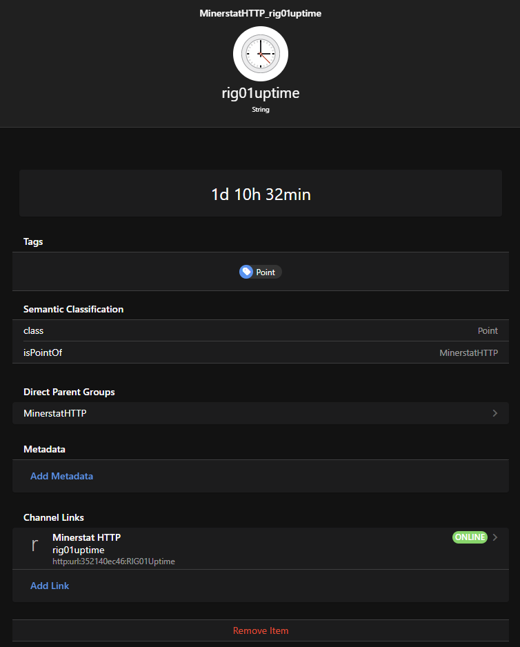

i just added a HTTP Binding and on the Items page i get the correct value.
But on my sitemap / mobile app, it’s empty, there is no data displayed. Is there a way to debug this?
If the item displays the correct value, it‘s not related to the binding.
Try it with adding Metadata: State Description -Pattern: %s to the item. That way the sitemap “knows” what it should display besides the label.
Thanks that was the solution, but it should be %s Thank you
