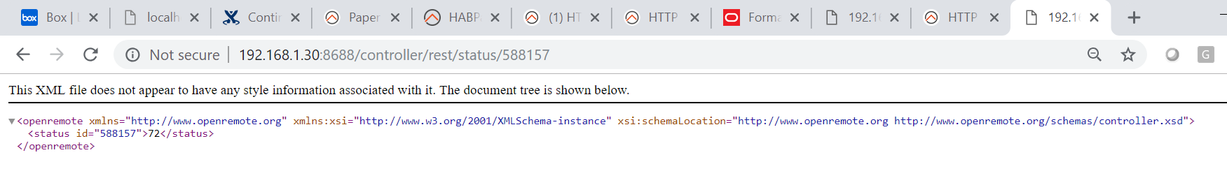

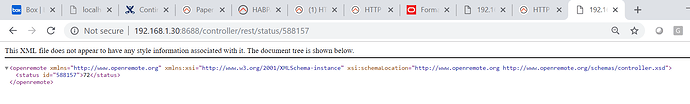

Also, how do get the current status to show up on the habpanel- i tried creating the following item and mapped it to a dummy widget but it is not displaying the values correctly. This same url from a webbrowser returns the values correctly.
Number DinningRoomLightStatus “Dimmer Status” { http=“<[http://192.168.1.30:8688/controller/rest/status/588158]” }
how does it come up in HABPanel? Does it work ok on BasicUI?
try:
Number DinningRoomLightStatus "Dimmer Status [%d %%]" { http="<[http://192.168.1.30:8688/controller/rest/status/588158]" }
Read: How to use code fences It is important :slight_smile:
it is not display any values at all.. shows N/A
Where can i get the latest version of the http binding? may there are issues with the binding that comes with OH2.3
what is the exact output of the http call using a browser?

URL : http://192.168.1.30:8688/controller/rest/status/588158
Returns:
<openremote xmlns=“http://www.openremote.org” xmlns:xsi=“http://www.w3.org/2001/XMLSchema-instance” xsi:schemaLocation=“http://www.openremote.org Documentation to build your own open source IoT platform | OpenRemote”>
<status id=“588158”>on</status>
</openremote>
URL : http://192.168.1.30:8688/controller/rest/status/588157
Returns:
<status id=“588157”>72</status>
</openremote>
this is how it is displayed on the browser? (if it’s not too much trouble, upload a screenshot please)
If this is the string output, you need another solution to process the value of interest (e.g. the 72)
image attached above. 588157 is the dimmer and 588158 is the switch. physically they are both in one switch / dimmer. I tried using the following for them:
