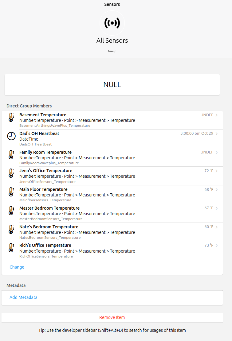

I’m not certain I know what that is referring to. Frankly, I don’t use text file configs for anything in OH any more except for a few functions I have in a personal JS library.
But I do use some metadata on a few of my sensor Items so they can have a unique timeout.
So you see my config above for the Threshold Alert rule (post #4 I think).
The Group Item I use to trigger this rule is called “Sensors”.
Note I’m showing screen shots here so you can see what I see. Normally it’s better to click the code tab and paste the YAML for a forum post.
Each of those Items get updated periodically but they are not all on the same cadence. So if we look at one of them. Hmmm, I need to replace the batteries in the basement Airthings WavePlus so let’s look at my wife’s office temp.
The important part is under Metadata. You can see above I’ve defined the namespace for my instance of the Threshold Alert rule to be “sensorStatus” and you can see an entry under metadata for that. Opening that up shows:
value: " "
  alertDelay: PT10M
For this one Item therefore, instead waiting for no updates for fifteen minutes (defaultAlertDelay: PT15M) this one Item will only take ten minutes (PT10M). Any of the other properties can be overridden in this way for each individual Item. More details are in the post for the Threshold Alert rule template.
That’s pretty much all I ever override at the Item level. I have a different time for my open door reminders, sensor offline detection, humidity alerts, etc (I have lots of instances of this rule in my setup, it makes up roughly a third of all my rules).
Item metadata is optional though. You don’t need it. It’s only there to handle the case where you have one rule where there’s just one or two properties that need to be handled differently for certain Items. It’s better than requiring creating a whole new instance of the rule. But if all your Items work the same, no metadata is required.

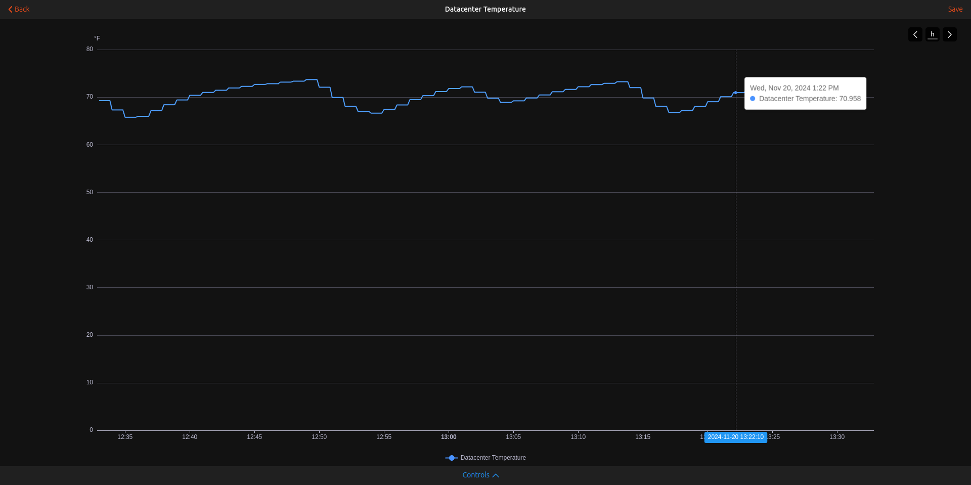

I ask because I see alerts when set to 15M, but the graphs show changes.
2024-11-20 13:30:00.685 [INFO ] [.openhab.automation.script.ui.alarms] - Item Datacenter_Temperature alerting true initial alert false

What is the refresh rate of the Item? It’s hard to tell from the graph. It looks like maybe one minute?
It’s hard to tell with just that statement whether this is the alert call to your rule or a reminder call. If it’s a reminder call, maybe there’s a timer somewhere that’s not getting cleaned up.

I have my sensor Items configured with Expire to go to NULL after a time of no updates, which is left over from before I wrote this rule template. You’ve not mentioned if you’ve done this or not. If the Item doesn’t move to an UnDefType then as far as TA is concerned, the Item has never stopped alerting and therefore the reminder timer continues to run, reminding you that it’s alerting every hour. As soon as the Item becomes an UnDefType the alert is cancelled and the reminder timer gets cancelled (and the endAlertRule gets called with alarm == false and initialAlarm == false).
I think it’s not optional to set the Expire timer on the sensors here and I just got lucky. The alert must be cleared and the only way for that to happen is for !(item.isUnitialized) to be false (i.e. the state of the Item has to be NULL or UNDEF.
Note, there is a 1.4 version of the rule template that fixes a bug in the UnDefType handleing. Make sure you are running that (the version is in a comment at the top of the script action of the rule created from the template).
Ah, ok, I am currently not using Expire on sensors. You mention that it’s not option to set the Expire timer on the sensors, if I understand using Expire to set to UnDefType, that would only happen if they stop updating. If the rule started when all sensors are working, how do they ever get clear up the old reminders?
