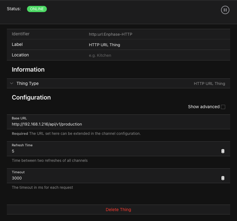

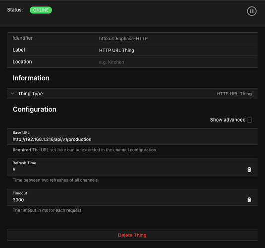

I have created the HTTP thing,

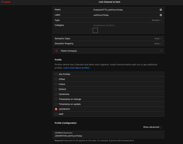

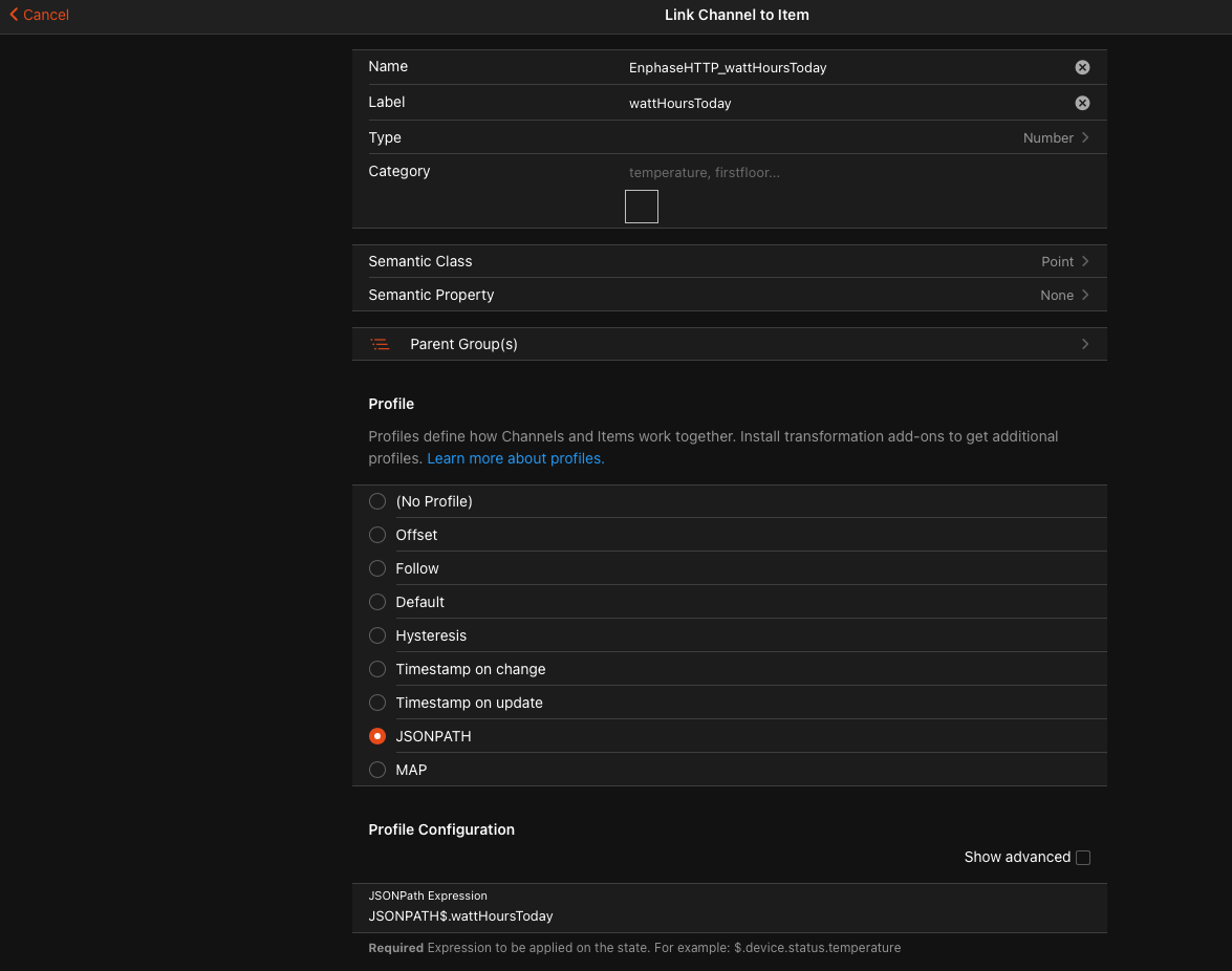

  • When I put the JSONPATH$.wattHoursToday in the Link to Item, I get this in the logs,
    2021-02-27 12:10:54.519 [WARN ] [ofiles.JSonPathTransformationProfile] - Could not transform state 'UNDEF' with function 'JSONPATH$.wattHoursToday' and format '%s'

When selecting a profile from the UI, you’ve already selected JSONPATH and so you only need the parameter/pattern in the text box
$.wattHoursToday
But use the channel method here, set your profile back to default.

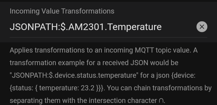

You’ll see the colon after JSONPATH. I thought that the UI would show the correct syntax, but it seems like the HTTP Binding doesn’t. Here’s what a similar field for the MQTT Binding shows:
