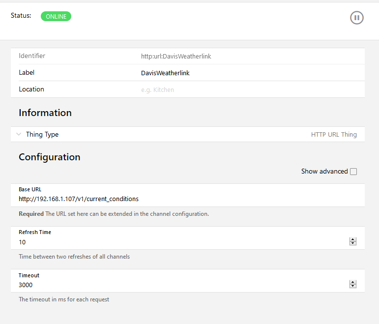

I used to have HTTP binding to retrieve information from my wheather station. I dont seem to get it to work in openhab 3.
Http.cfg in openhab 2
granularity=30000
davisLiveLinkCache.url=http://192.168.1.107/v1/current_conditions
davisLiveLinkCache.updateInterval=30000
Items file
Number davisOutsideTemperatureJSON { http=“<[davisLiveLinkCache:30000:JSONPATH($.data.conditions[0].temp)]” }

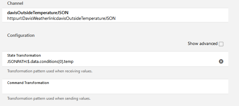

In openhab 3
Channel
No data is retrieved, what i’m i doing wrong
Your log may give a clue?
Do you have the JSONPATH Transformation Service installed?
How do you come to this conclusion? Do you have it linked to an Item?
Thanks installing the JSONPATH Transformation service fixed the problem.
