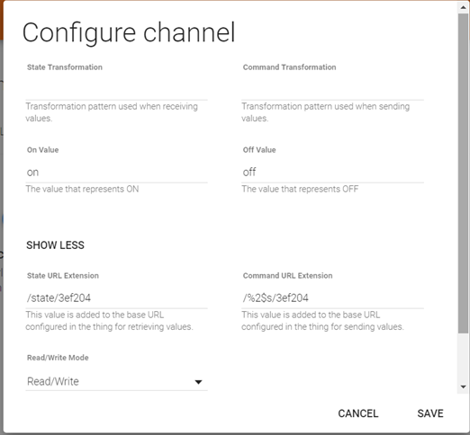

I think that /%2$s/3ef204 as commanfExtension should work. You need to set onValue to on and offValue to off.
This is now working for commandExtension, thanks! :slight_smile:

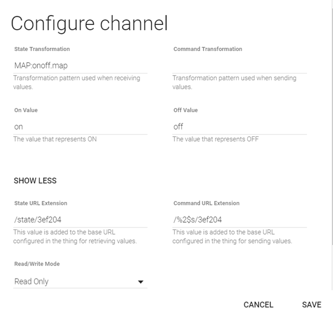

But the state is “on” or “off” with the quotation marks! That’s why I used MAP (see example above).
How to set the State Transformation?
EDIT: I now found out on my own! :slight_smile:
State Transformation: MAP:onoff.map
and the onoff.map must contain the following:
"on"=on
"off"=off
Now it works very well! Many thanks to @J-N-K !
