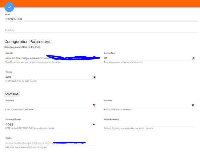

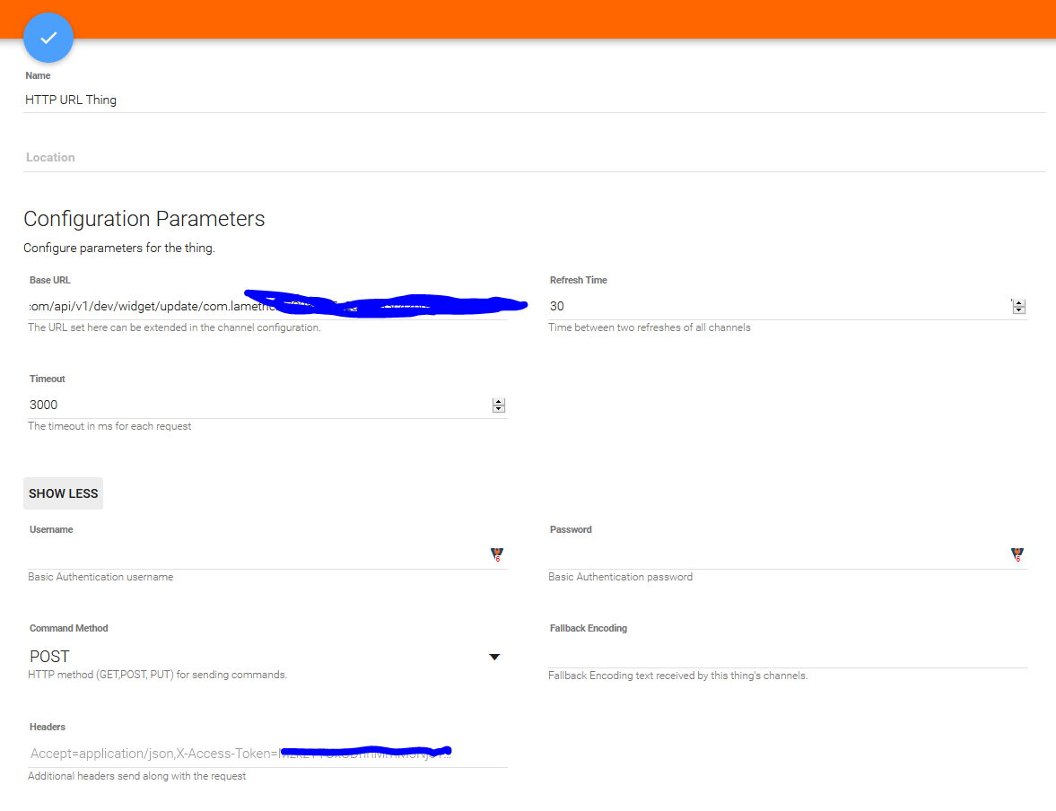

How do I define multiple header entries?
Like:
Accept=application/json,X-Access-Token=MYTOKEN
PaperUI? Just add a second entry. It automatically does that.
OK, got it.

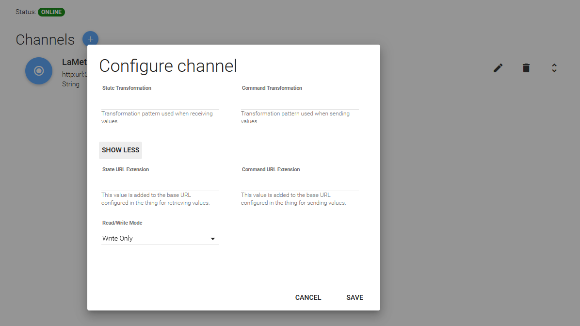

Another question: I’m trying to send a JSON string as the payload:
{'frames':[{'text':'TEST1','icon': 'a36755','index': '0'}]}
but then I’m getting:
2020-07-11 21:30:44.910 [TRACE] [nding.http.internal.HttpThingHandler] - Sending to 'ttps://developer.lametric.com/api/v1/dev/widget/update/com.lametric.xxx/3': Method = {POST}, Headers = {Accept-Encoding: gzip, User-Agent: Jetty/9.4.20.v20190813, Accept: application/json, X-Access-Token: TOKEN}, Content = {笧晲慭敳✺孻❴數琧㨧呅協ㄧⰧ楣潮✺‧愳㘷㔵✬❩湤數✺‧〧絝}
2020-07-11 21:30:44.912 [WARN ] [nding.http.internal.HttpThingHandler] - Failed to convert command '{'frames':[{'text':'TEST1','icon': 'a36755','index': '0'}]}' to channel 'http:url:5080968a:lametricapp' for sending
It seems the content is messed up. What did you configure?
Is there a typo? The h at the beginning is missing?
Oops.. yes. Nice catch.

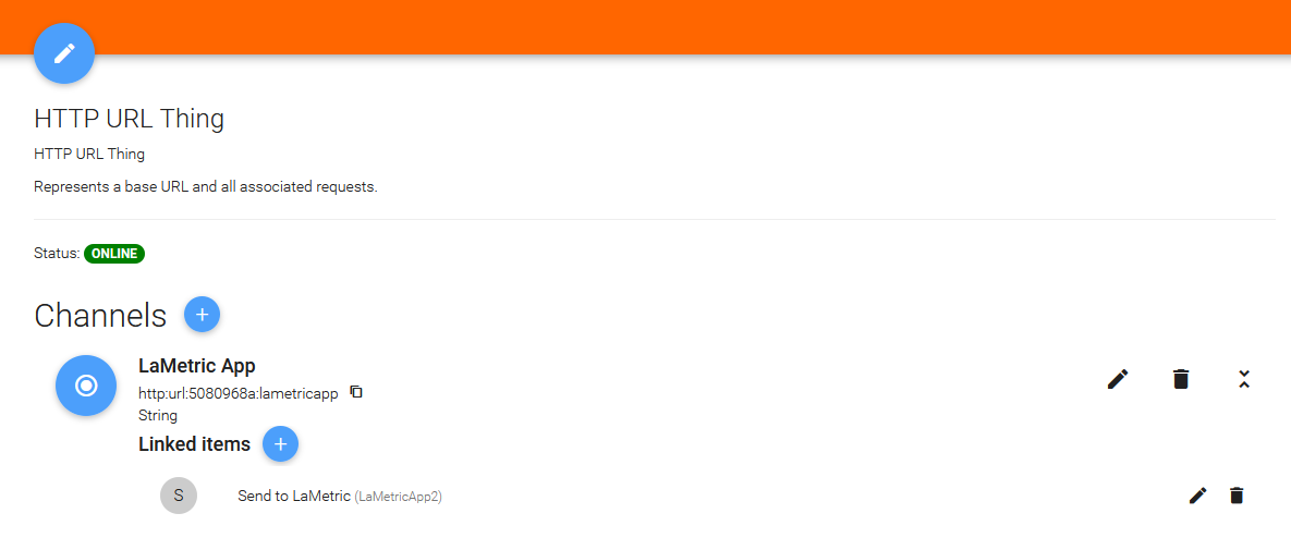

Now I’m getting:
2020-07-11 22:01:12.038 [ome.event.ItemCommandEvent] - Item 'LaMetricApp2' received command {'frames':[{'text':'TEST','icon': 'a36755','index': '0'}]}
2020-07-11 22:01:12.059 [TRACE] [nding.http.internal.HttpThingHandler] - Sending to 'https://developer.lametric.com/api/v1/dev/widget/update/com.lametric.123/3': Method = {POST}, Headers = {Accept-Encoding: gzip, User-Agent: Jetty/9.4.20.v20190813, Accept: application/json, X-Access-Token: TOKEN}, Content = {笧晲慭敳✺孻❴數琧㨧呅協✬❩捯渧㨠❡㌶㜵㔧Ⱗ楮摥砧㨠✰❽嵽}
2020-07-11 22:01:12.178 [TRACE] [p.internal.http.HttpResponseListener] - Received from 'https://developer.lametric.com/api/v1/dev/widget/update/com.lametric.123/3': Code = {400}, Headers = {Server: nginx, Date: Sat, 11 Jul 2020 20:01:12 GMT, Content-Type: application/json; charset=UTF-8, Content-Length: 90, Connection: keep-alive, X-Content-Type-Options: nosniff, X-XSS-Protection: 1; mode=block}, Content = {{"error":{"code":null,"message":"Bad Request","trace":["request body must not be empty"]}}}
Why is there the chinese characters. Is there something off with the encoding?
That’s only a logging issue. Fixed in a new jar. Maybe the problem is the missing content-type. I’ll add support for that ASAP. But not this evening.
The chinese is gone! The content looks correct.
Will be happy to test again when you find the time. Have a nice weekend!
I added a new configuration option contentType. Unfortunately I can’t test if that solves your problem.

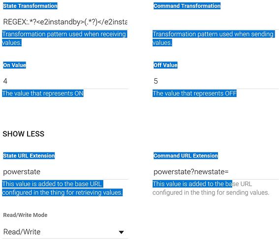

I’m failing to get another complex case to work. Maybe it could serve as an example once I get it to work.
Wanted: a “Switch” item to retrieve and send status/ON+OFF commands via HTTP
The base URL of the Thing is http://<IP>/web, channel config see below.
On retrieving URL/powerstate, the URL returns an XML that I can parse with a transformation (that worked in httpv1):
<?xml version="1.0" encoding="UTF-8"?>
<e2powerstate>
        <e2instandby>true</e2instandby>
</e2powerstate>
First problem is that state retrieval for this item does not work - item remains UNDEF. Thing is ONLINE. Although I have trace logging, I see no "GET"s logged, just “execute() called”.
TCPdump however reveals there’s requests going and being answered.
Second, on changing item I want it to POST URL/powerstate?newstate=4 if “ON” and 5 for “OFF”.
But I see the number is missing in the URL. Do I need a command transformation ?

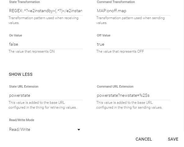

@mstormi
One question.
Your state <e2instandby>true</e2instandby> represents true=OFF, false=ON ?
(in standby=true means power=OFF, in standby=false means power=ON ?? )
If so, then you should try MAP transformation e.g onoff.map for Command Transformation:
Content of onoff.map:
4=false
5=true
OR
false=4
true=5
And your channel definition then could be:
