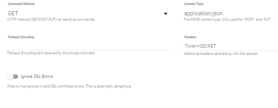

I can read the values for 3 channels via GET method, but I need also a GET Method to set a switch item to ON & OFF.
here is the output when I set it via curl:
# curl -i -H "Accept: application/json" -H "Content-Type: application/json" -H "Token:SECRET" 'http://10.0.1.27/relay?state=1'
HTTP/1.1 200 OK
Pragma: no-cache
Cache-Control: no-store, no-cache
Content-Type: text/plain
Content-Length: 0
Connection: close
In the old binding, I defined the item that way:
ON:GET:http://10.0.1.27/relay?state=1{Token=SECRET}
OFF:GET:http://10.0.1.27/relay?state=0{Token=SECRET}
When I configure the channel that way, I get an exception in openhab.log.

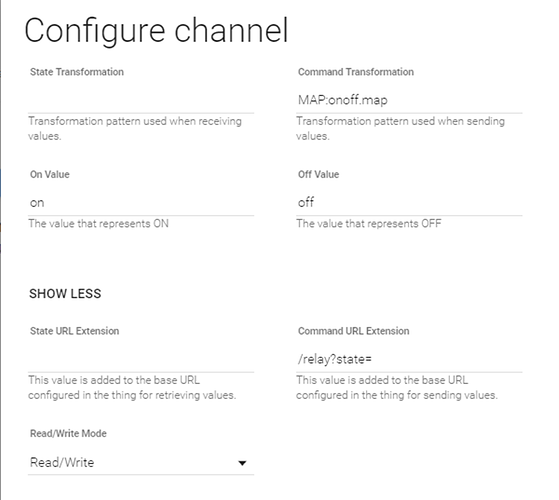

@HaKuNa

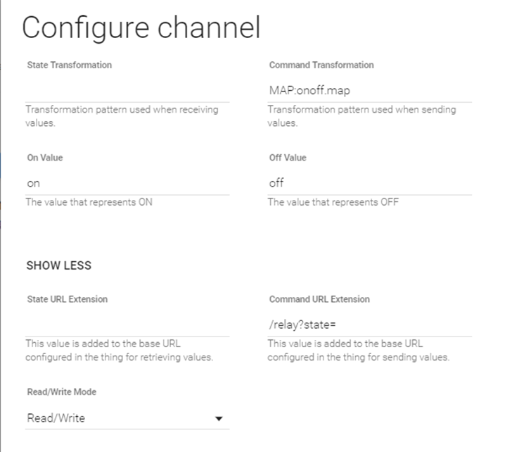

I would also try MAP transformation with e.g. onoff.map
Content of onoff.map:
1=on
0=off
And your URL Definition should be:
This was the right direction, thanks.

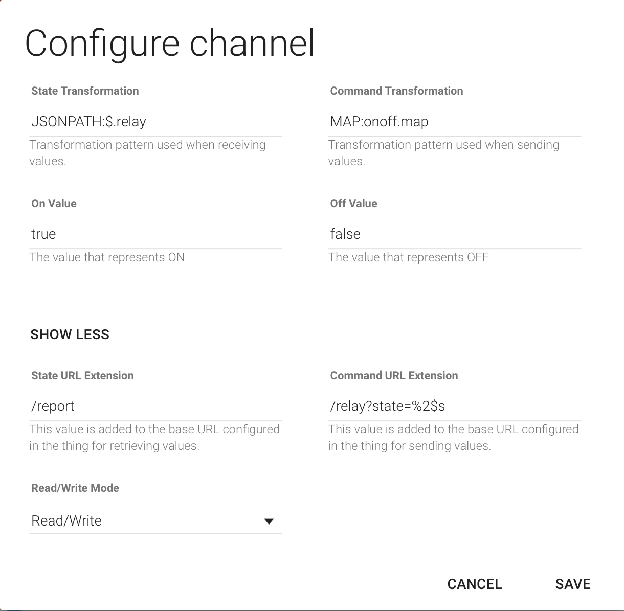

my map file:
true=1
false=0
and the channel definition:

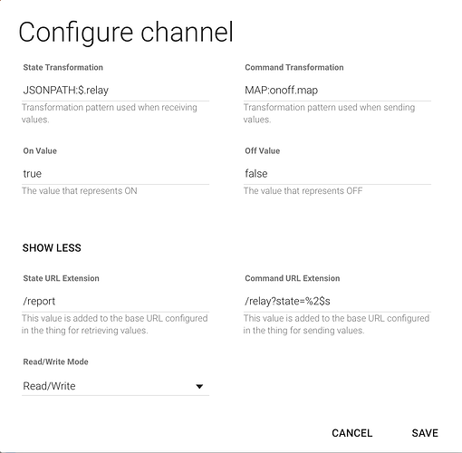

Thanks for your snapshot. The missing part actually was that I need to use %2$s for the state argument. @J-N-K if I didn’t overlook it that’s not documented ?
It in documentation at the bottom. See here.
https://github.com/J-N-K/openhab-addons/tree/http/bundles/org.openhab.binding.http#url-formatting

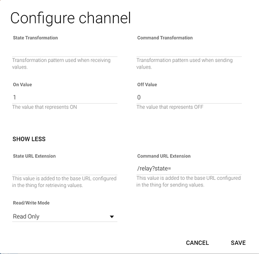

That doesn’t seem to work properly yet.
On my last example (to read and write the channel), State URL Extension was ignored.
And when I’ve set it to empty (but readwrite mode), I got an exception on saving saying
2020-07-22 22:31:15.968 [ERROR] [nal.common.AbstractInvocationHandler] - An error occurred while calling method 'ThingHandler.thingUpdated()' on 'org.openhab.binding.http.internal.HttpThingHandler@163344': String index out of range: 0
java.lang.StringIndexOutOfBoundsException: String index out of range: 0
        at java.lang.StringLatin1.charAt(StringLatin1.java:47) ~[?:?]
        at java.lang.String.charAt(String.java:693) ~[?:?]
        at org.openhab.binding.http.internal.HttpThingHandler.concatenateUrlParts(HttpThingHandler.java:308) ~[?:?]
        at org.openhab.binding.http.internal.HttpThingHandler.createChannel(HttpThingHandler.java:191) ~[?:?]
With another thing which has no Command Extension, State Extension is working, but apparently not together with Command Extensions.
Actually those docs say %2$ but I had to use %2$s like in @Celaeno1’s example.
[quote=“mstormi, post:67, topic:101851, full:true”]
Well, that‘s not exactly true.
l. 101 states that the „format needs to be appended „ and l. 106 shows exactly %2$s. But probably this needs to be reworded to be more clear.
I took the string from your README.md (as most people will simply do rather than read java docs) so please fix it there
That‘s in the readme. Anyway, it should be made more clear.
just to mention where I found the information:
→ It is explained under “URL Formatting” here https://github.com/J-N-K/openhab-addons/tree/http/bundles/org.openhab.binding.http
http://www.domain.org/home/lights/23871/?status=%2$s&date=%1$tY-%1$tm-%1$td
There’s 2 occurences. The one in the URL you refer to is correct.
But there’s another one 4 lines up which is bad which is what I took.

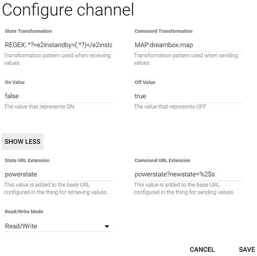

Thanks, it’s working as expected now. Here’s my promised complex example for your docs:

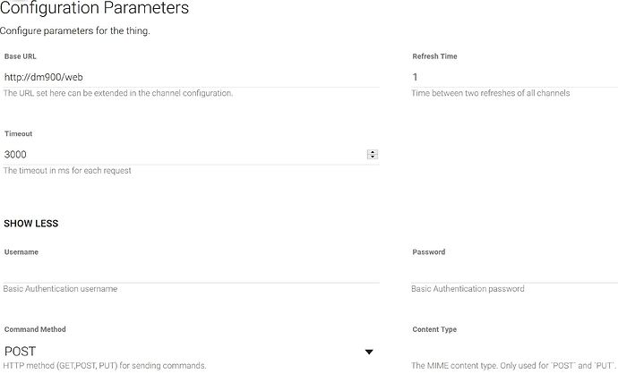

My ‘Dreambox’ TV receiver has an HTTP API. The hostname is dm900.
On requesting /web/powerstate, it returns an XML
<e2powerstate>
<e2instandby>false</e2instandby>
</e2powerstate>
meaning it is currently not in standby thus ON. A POST request /web/powerstate?newstate=5 will instruct it to switch OFF and newstate=4 means to switch ON.
The state transformation REGEX fully reads REGEX:.*?<e2instandby>(.*?)</e2instandby>.* and returns what is between <e2instandby> and </e2instandby>, i.e. false or true.
dreambox.map for the command transformation is
true=5
false=4
NULL=no data
-=no data
Very unlike the HTTPv1 binding, the item definition is only a very simple channel reference
Switch Dreambox "Dreambox [%s]" { channel="http:url:<thing ID>:<channel ID>" }
