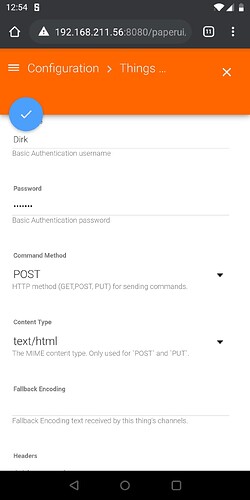

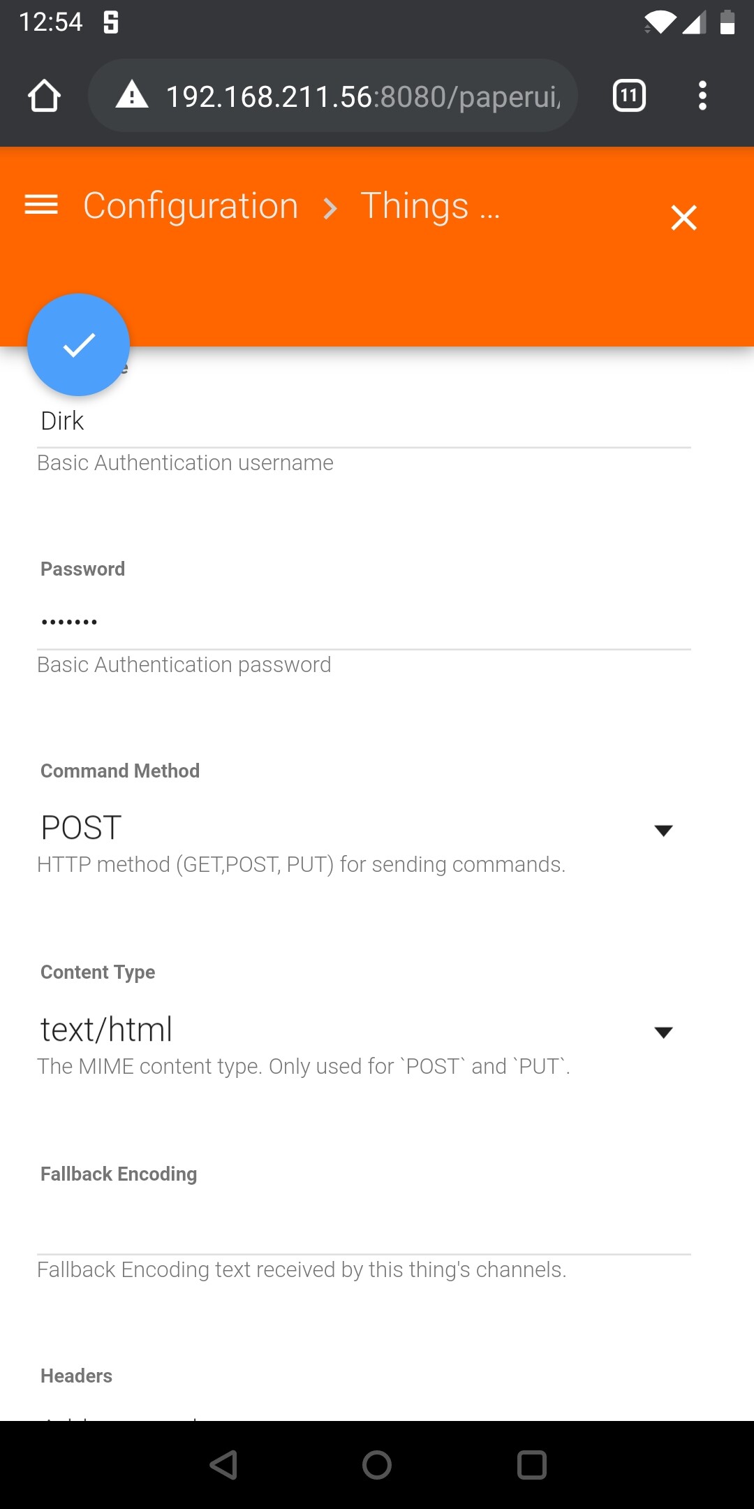

If have done that.
http://servicewelt/?user=Dirk&pass=******
But the login page uses POST to deliver the credentials, so I wonder if I have to configure the binding to use POST too.
I guess “text/html” is wrong. I always try via curl to fetch the data first. There you can add credentials, header, content-type … Afterwards you can transform the parameters to the thing in openHAB.
I don’t know if you need POST or GET for your call.

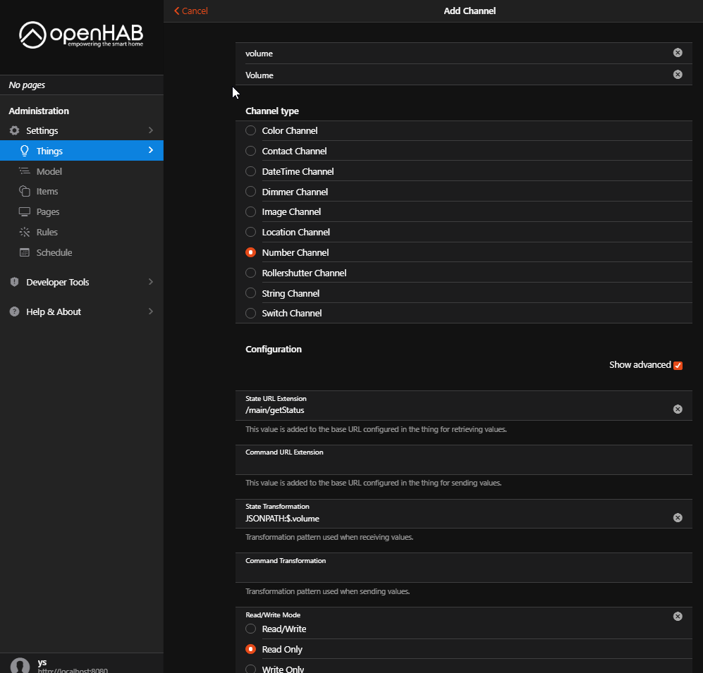

but to update the volume I need to do a GET (for some reason?) like /main/setVolume?volume=67

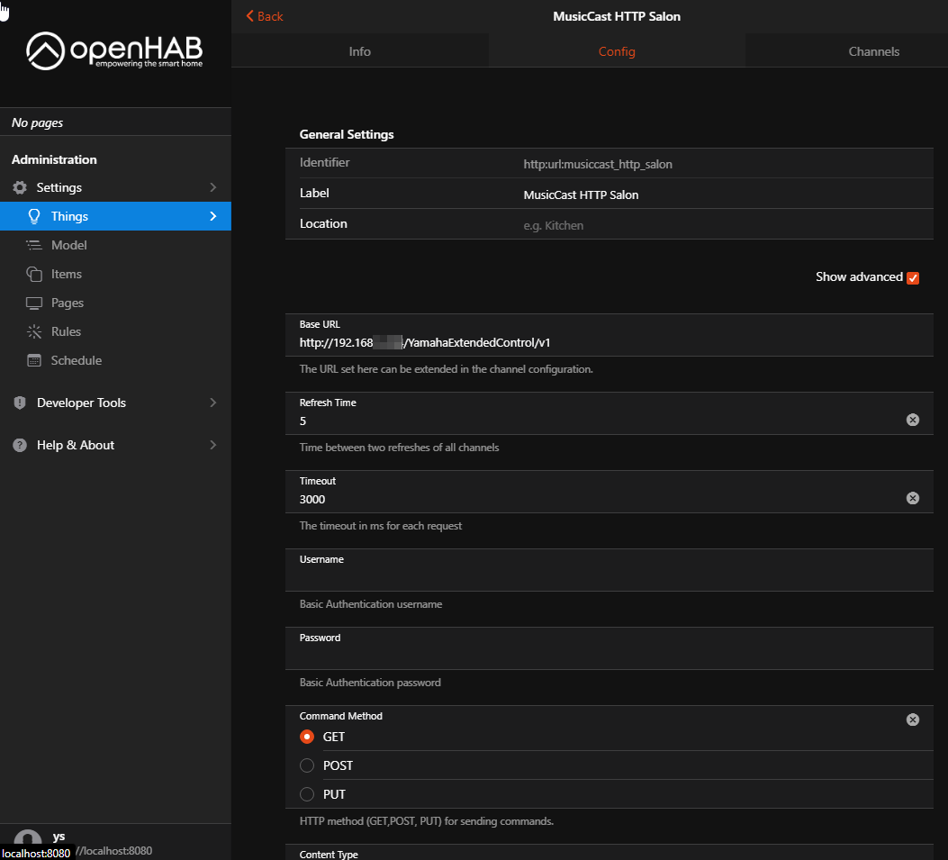

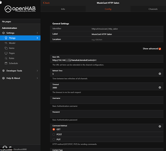

So I found the Command method advanced parameter of the Thing which I changed to GET (and reduced the polling to every 5 seconds):

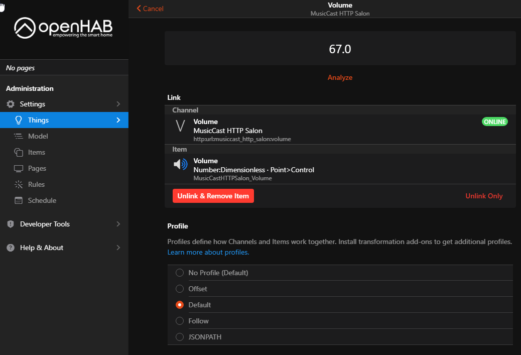

And created a Number channel (read only) with the JSONPATH:$.volume transformation:
I then created & linked an item to verify the volume was properly retrieved and parsed into the item’s state:

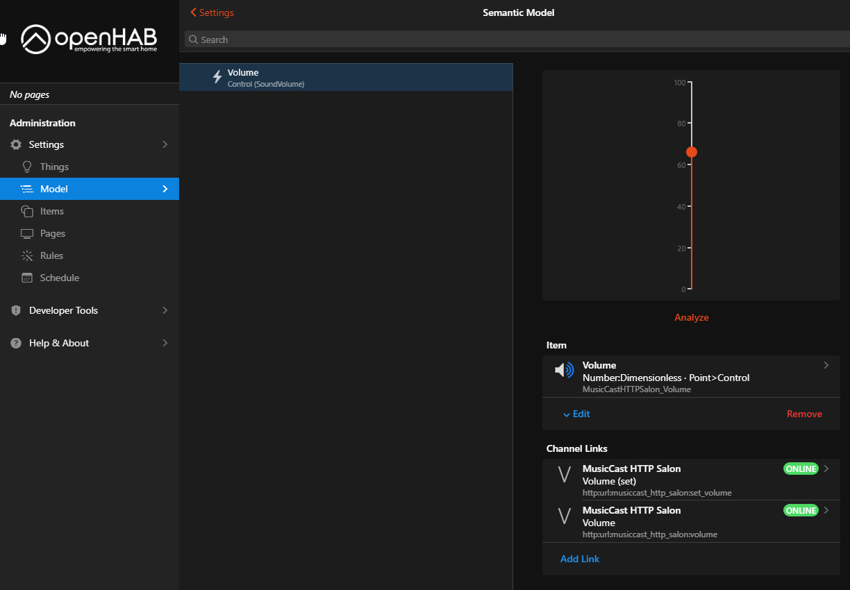

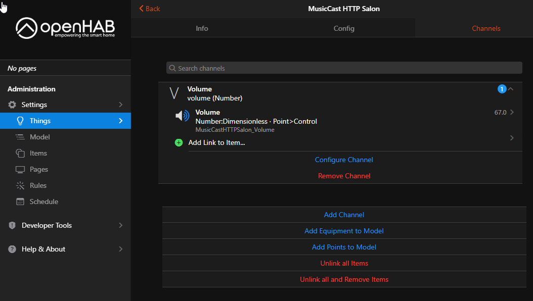

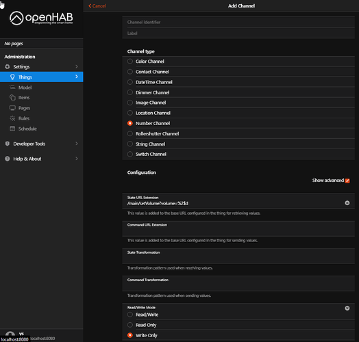

Next I wanted the same item to also control the volume when receiving commands, so I created a second write-only channel. Oddly enough I made a mistake and set the “State URL Extension” instead of “Command URL Extension” to /main/setVolume?volume=%2$d but it still worked:

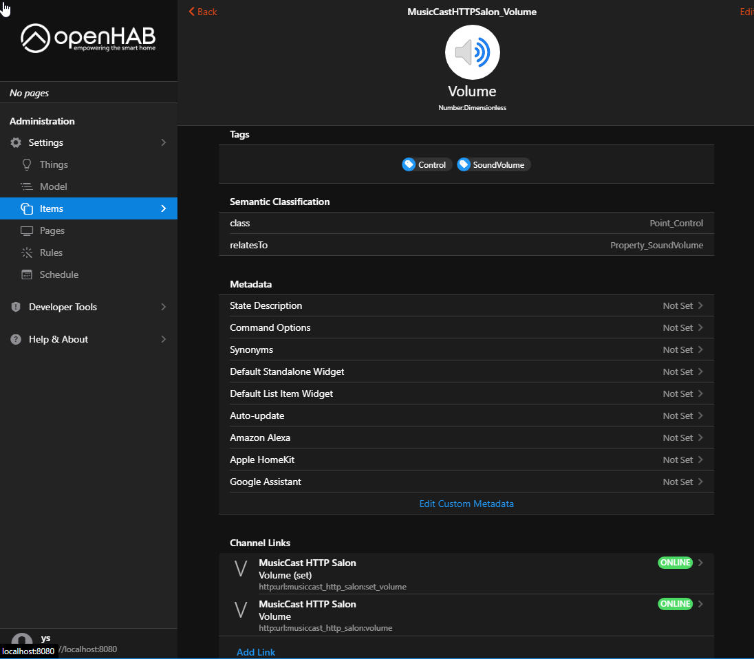

Then I linked the same item to that channel (you can do that in a number of ways, from the Thing page, the Model page, or the item details page):
I saw @mstormi’s solution which is better only after doing that - a single channel would have sufficed!

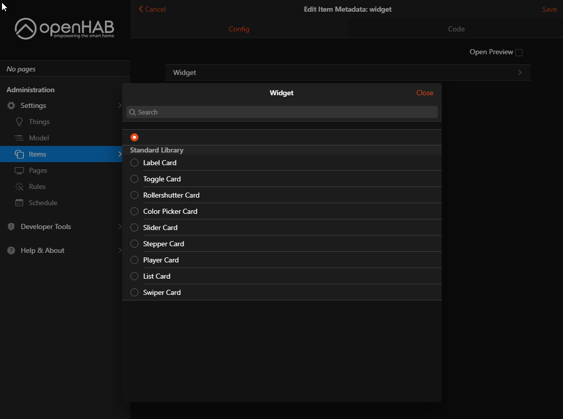

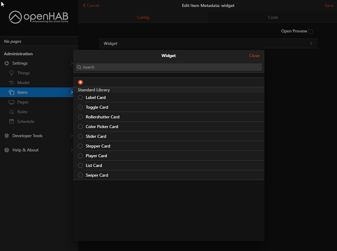

Finally since this Number item is controllable I set the “Default Standalone Widget” metadata to override the default which is a simple label card for this type of items, selected “Slider Card”, and changed some options.
Now the item represents the current volume in a slider with its default control, and operating that slider changes the volume as expected. Great!

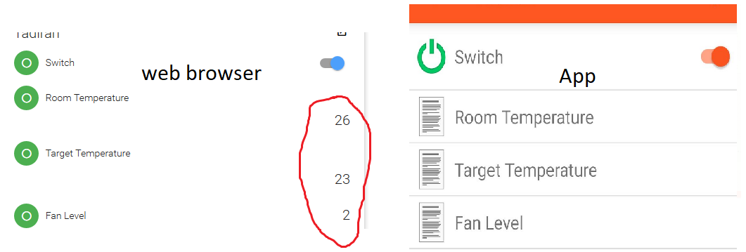

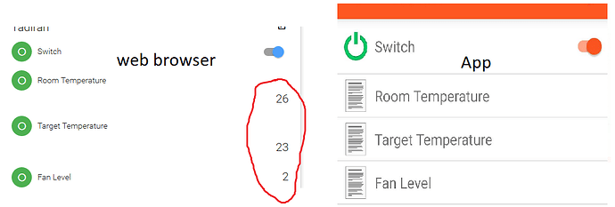

I have something strange behavior with the addons.
The data from text and number channels aren’t shown in a native OB application (Android & IOS), from the web-browser everything is work.
Any clue?
Look in your events.log. If your Items do not get updated, there is nothing to show.
