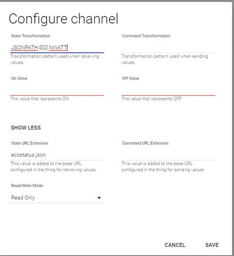

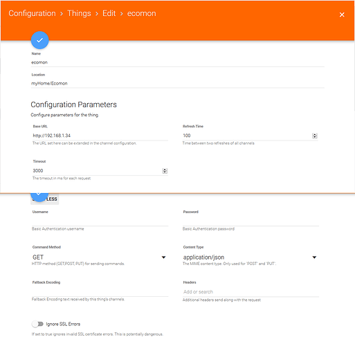

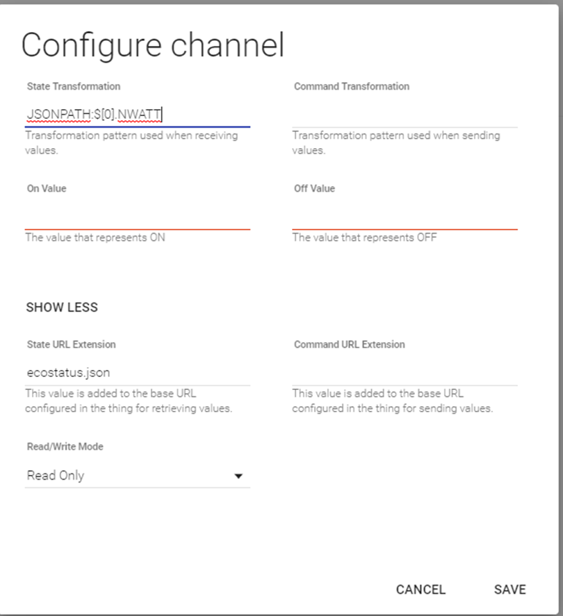

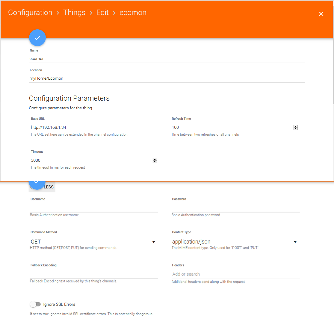

I’m not using things or items files I’m doing everything in PaperUI until I get it working. I tried the square brackets but still got the same error. Why does the error contain pattern=‘($.(0).WATT)’ no matter what syntax I use? Maybe that’s the clue.
this is my Thing in PaperUI
and this is one of the channels
No, you have to write the following under Configure channel:
I showed that in the list of variations above. I’ve put the JSONPATH: back in each of the channels but it makes no difference I still have exactly the same error.

According to this page (https://jsonpath.herokuapp.com/), the following values are valid for JSONPATH:
$.[0].NWATT
or
 $[0].NWATT
I pasted the content of @lesterb s ecostatus.txt there. Then filled in a line below $[0].NWATT and then pressed Go!
And got the result: 2540.969
If that’s wrong, please enlighten me.
Hi Alex,
You are correct. I thought I had tried JSONPATH:$[0].NWATT before but I couldn’t have because that syntax stops the error.

I’ve added the username and password in my thing but I still don’t see any data in the string channel I created. Thanks for the suggestion rossko.

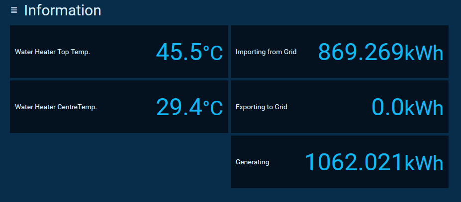

I have it working. Here is the info displayed in HABPanel.
