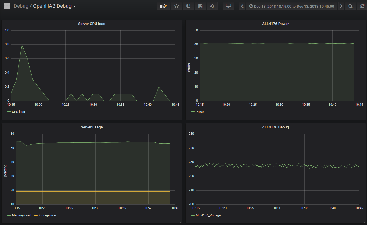

On 2018-12-13 10:16 I restarted OpenHAB and the dropouts disappeared (see lower right pane, one log every 10 to 11 seconds):
Logging_2018-12-13

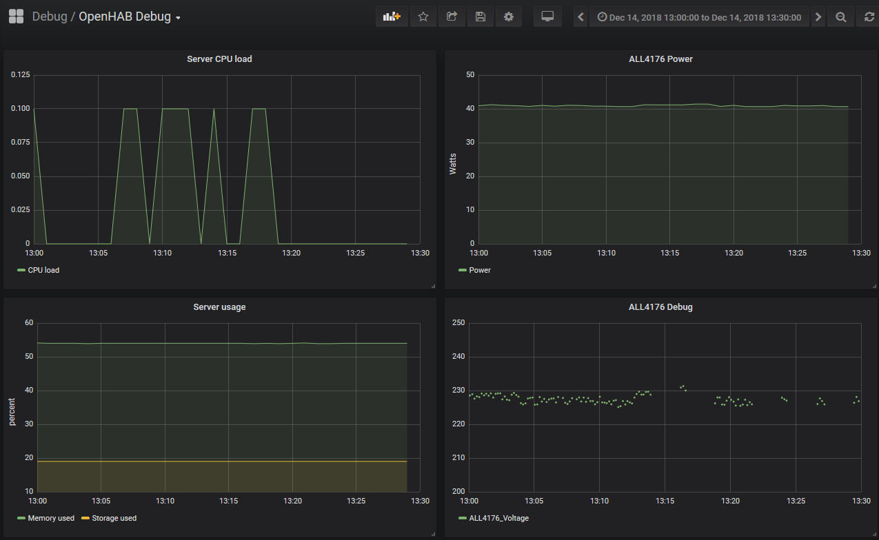

One day later, 2018-12-14 13:13:54 - 13:16:13 is the first outage, no data gets read in, despites CPU load and memory usage are still the same:
Logging_2018-12-14

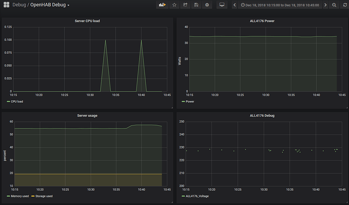

This continues even until today:
Logging_2018-12-17
Logs shows same behavior, but Grafana it more graphic :slight_smile:

It’s even getting worse today:
Logging_2018-12-18
I analyzed the logs from yesterday, it’s always the same:

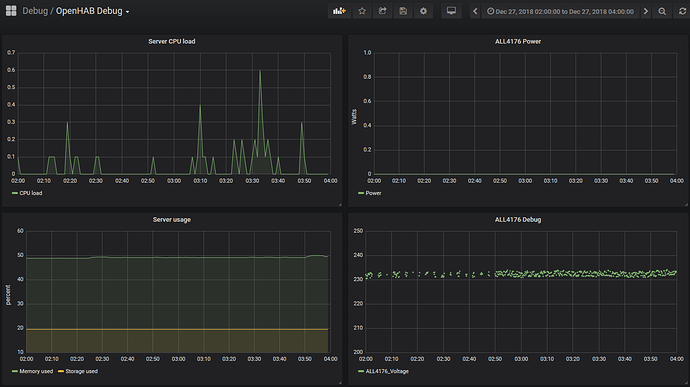

Some days later I finally restarted OpenHAB and target hardware - and still experienced the outages.
Then finally on December 27th in the middle of the night, it worked again (until now).
I didn’t change anything there, openhab.log and events.log don’t tell interesting things for that time, even syslog is empty between 2:00 and 3:00 am.
Logging_2018-12-27
So I currently don’t know where to look for tracking down the root cause, but I’ll try to reduce the number of HTTP requests and caches.

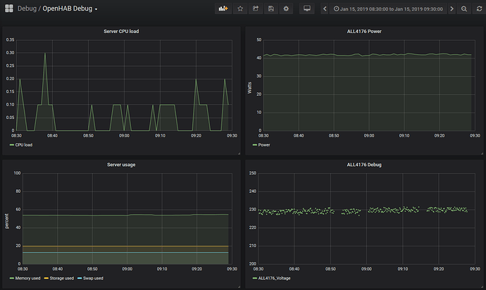

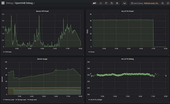

Update earlier than I thought… About 12:05 the server started to go wild. I also have a network:pingdevice set up for the device, this was always ON and now started to switch to OFF and back about every second minute - despites a (system) ping worked flawlessly during this time. Updates to Influxdb also got less and less.
I did a OpenHAB restart at about 12:30 and now it works again - I suppose that’s the behaviour I observed at the beginning of this thread.
Logging_2019-01-02
Log showed errors like this:

… and yes, I can see a drop in memory usage (and swap usage I added before restart).
So it looks like a plain memory leak?
… and same symptoms again starting at 17:01 - I didn’t change anything but the added swap used Item and logging with persistence. Why is OpenHAB running wild?
(data between 17:34 and 18:00 is invalid because it’s interpolated linearly)

… and there it is again, started at 2019-01-15 8:50:
Logging_2019-01-15
