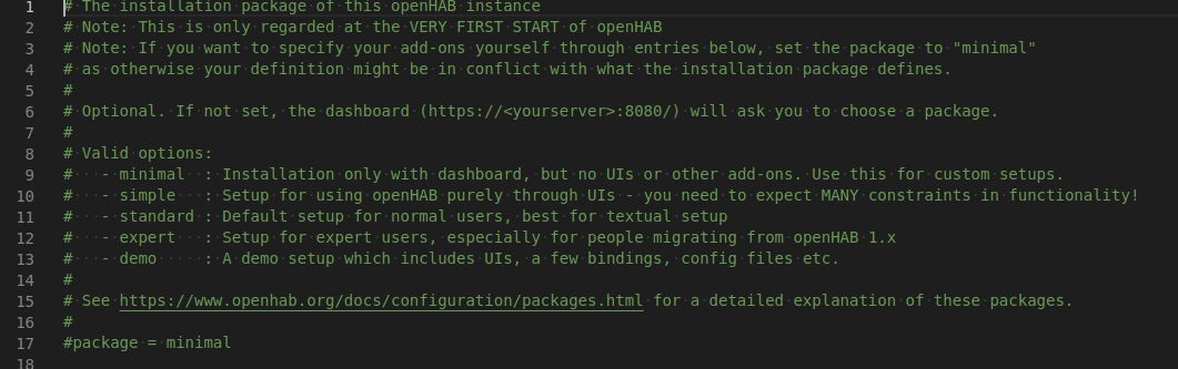

What kind of setup did you select at the initial setup? By chance “minimal”. You can change it in the file add-ons.cfg.

if i remember me correctl i selected “minimal” i will try to change it this evening.
i will change the value “minimal” to ?

You ned to change it in the "add-ons.cfg " , probably to “standard”. There are comments in the file to help you do it.
The file location is etc/openhab2/services from here you can use something like nano to edit the addons.cfg file e.g sudo nano addons.cfg or use VSCode to edit.
Uncomment package (remove the # at the front) and change minimal to standard then save (In nano Ctrl+X to close then press Y to confirm and save), exit and restart OH.

thanks it works now.
the package was set to minimal :wink:
