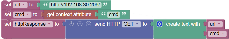

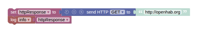

I worked a bit with the HTTP binding to get the correct commands sent via a rollershutter item, but never got it to work. I ended up creating 3 unlinked switch items that trigger the commands via rule. Which leads to creating a simple rule with Blockly to execute. Since all 3 switches are part of group, I wanted one rule to iterate through status of each and send commands (and also update a UI widget). The only HTTP block is:
or
The inline script stack block of course fits into the Logic block, but the HTTP does not. This lead to playing around to create a few blocks:
Both the inline script block and the blocks I created work fine, just wondering if there is a proper way to get the stock HTTP Block to work in my scenerio (asking as a JS novice). Here is the final generated rule:

The HTTP block doesn’t click in because it’s not a standalone block. It returns something, namely what ever was pulled from the HTTP GET request. Assign that to a variable and then it should click in place.
