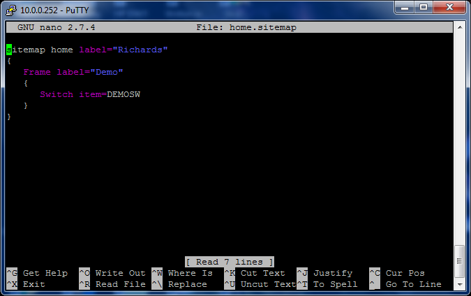

@MarineBoss, do you have a Home.sitemap file and does the first line of this file say sitemap Home?

@rlkoshak here is my sitemap.home located at openhabian@openHABianPi:/etc/openhab2/sitemaps
The file should be home.sitemap, not sitemap.home.
I miss typed mine is home.sitemap. I am just not sure why Basic ui works, but Classic doesn’t. I am worried that I have an error that will affect other things in my system. Plus as a programmer I hate having unexplained errors.

Classic is trying to find a sitemap with capital H
how did you specify the default sitemap for Classic? (is it Home or home?)
Case sensitive should have thought of that, working now and the Basic UI goes directly to the correct page without having to select a site map.
