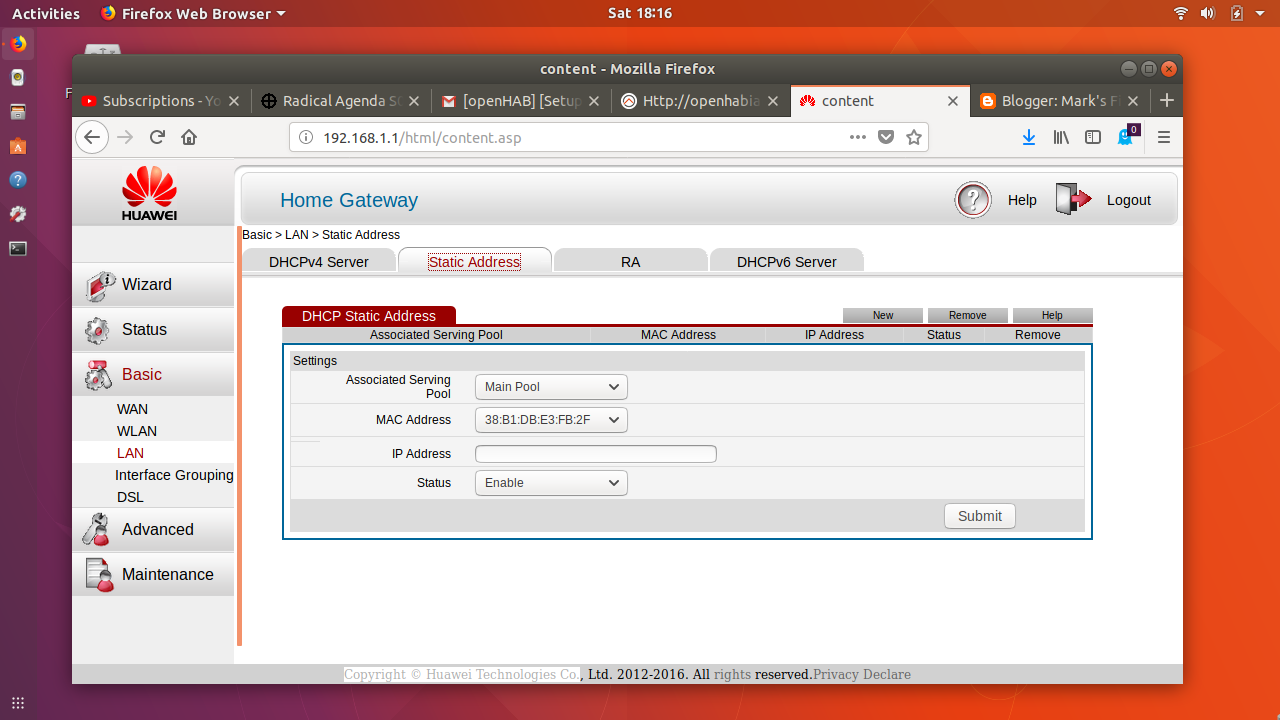

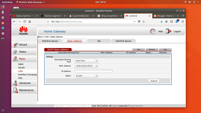

Hostname is done through your DHCP. Your openhabian pi will request the DHCP for a lease on that hostname. DHCP grants that request and reserves the hostname to that IP address based on MAC address. Is your DHCP working correctly? 99% of home users have the DHCP on the router itself. On your router, can you check if you can manually set a DHCP static route? For example, reserve MAC address of your pi to the hostname openhabianpi and point it to IP 1.2.3.4.

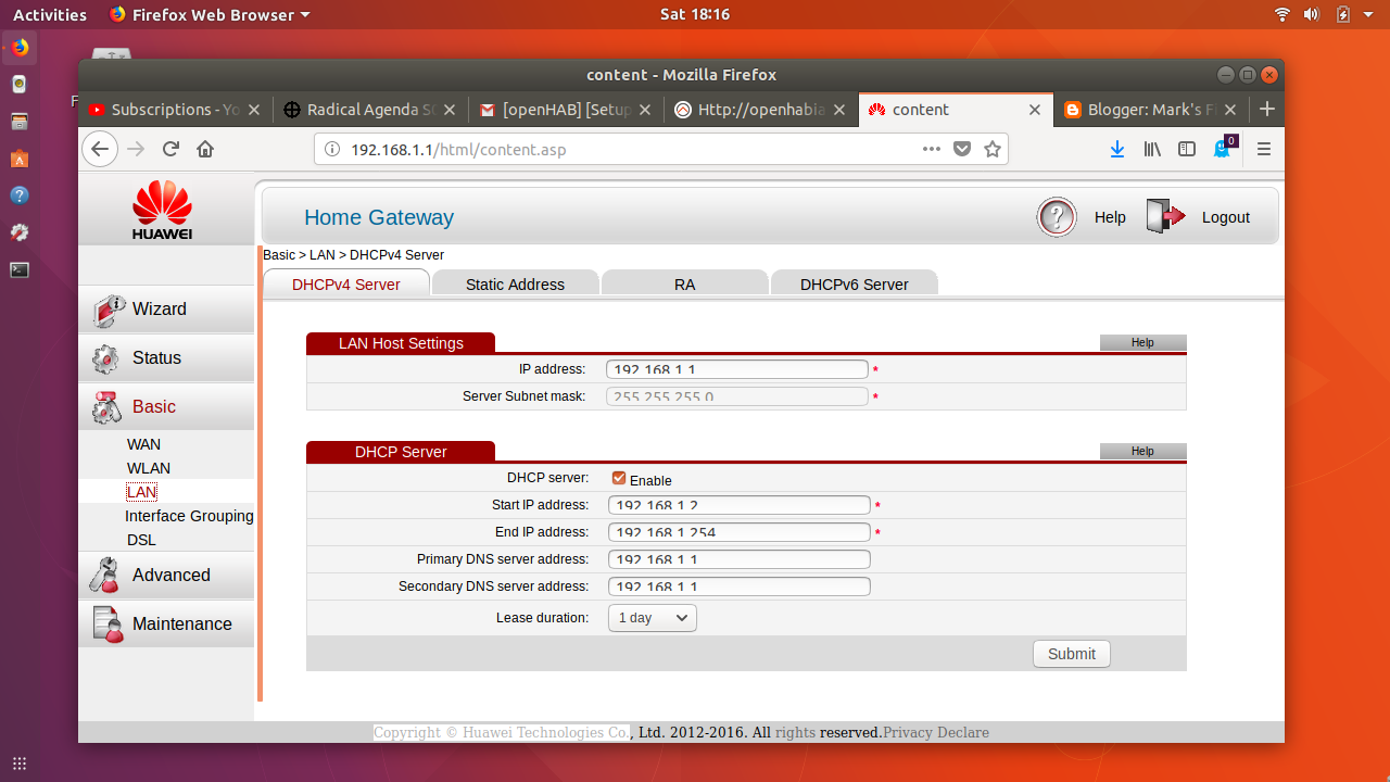

The Router was the one out of the cereal packet with iiNet. Huawei, I must confess I dont see any obvious options for setting up static IPs and assigning them to my http://openhabianpi:8080 host.

Can you check if the router has DNS server capabilities?

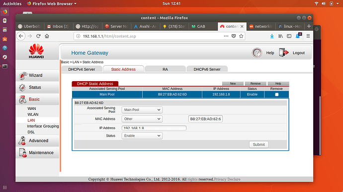

I assume this will always assign the IP 192.168.1.8 to that MAC address - i.e. it will be a “static address”. I have a notion it was already doing that since I found that MAC address in the list on the modem.

I will mark the question as solved because the static IP - MAC configuration on the router should mean no guess work using ssh or http. avahi is a whole level up and the ability to resolve the openhabpi.local hostname is not critical.
