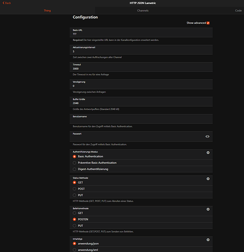

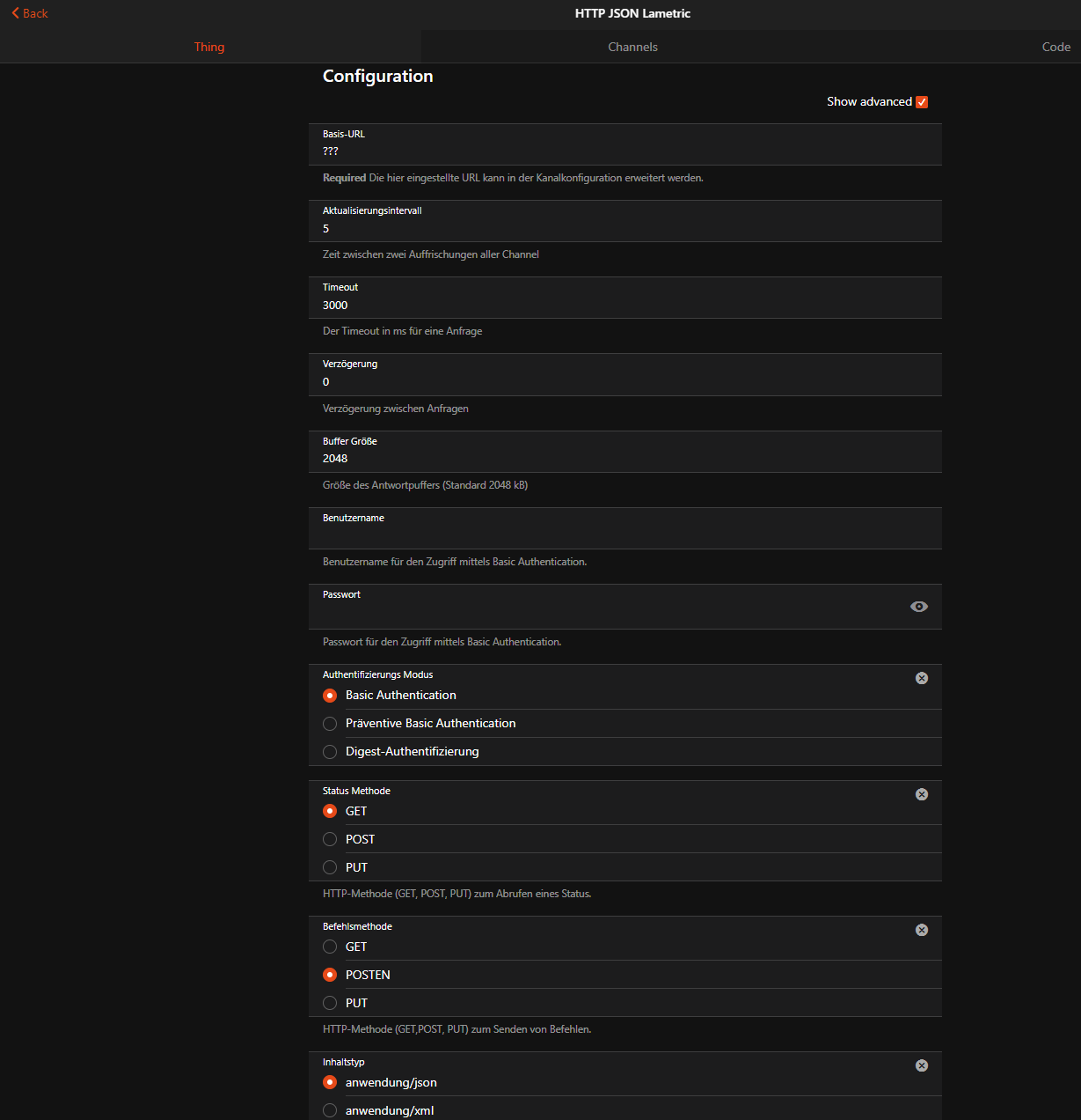

What about the HTTP binding and the configuration of the thing? Do i need a Channel in this Thing?
How to fill the field of the ā€œBasis-URLā€?
I was expecting that i have to do something in the area of this:
