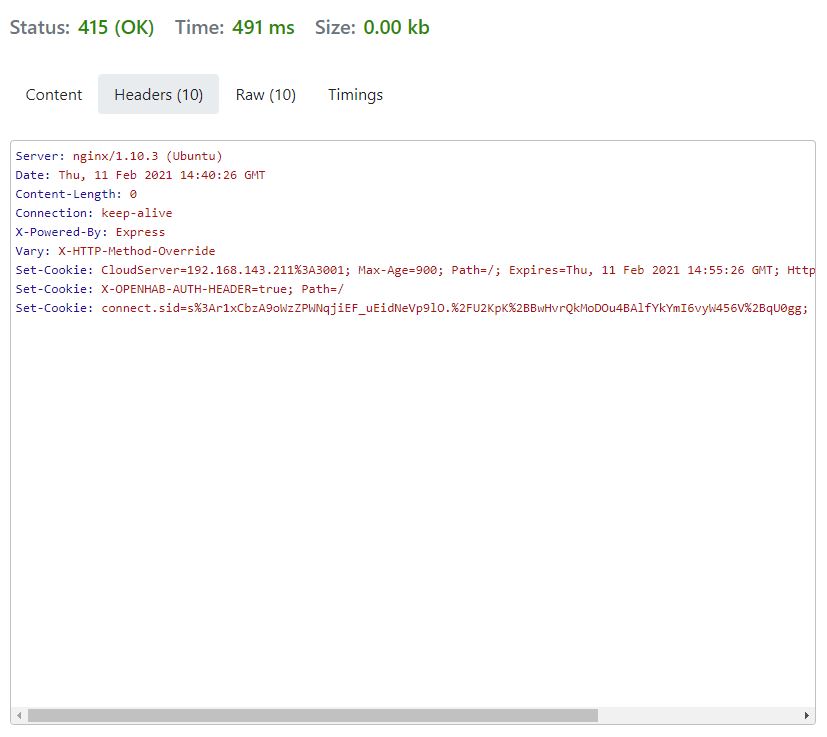

Then to test I went to “https://reqbin.com/ ”. → Picture attached.
But the values do not reach the system. Do I have to see that under items in the cloud?
Result:

If I change from “JSON” to “text” on https://reqbin.com/ , the values arrive in the oh3.
Unfortunately I need “JSON”.
Yeah 415 is a unsupported media type but its all just data and of you get that data into openHAB you can do something with it.
