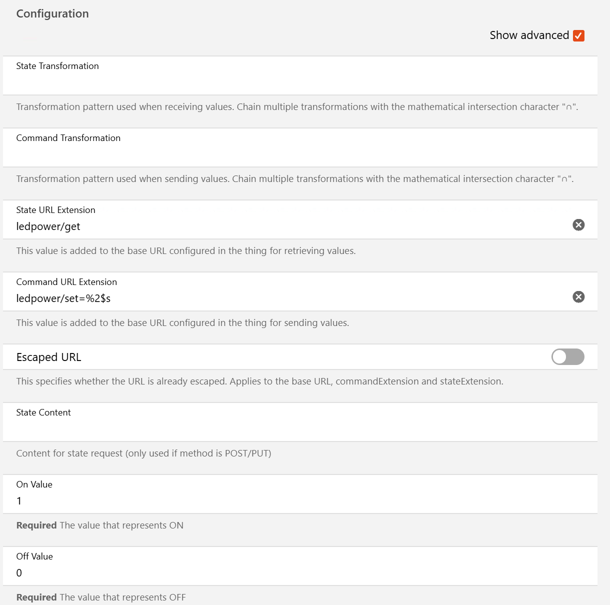

I’m stucked to setup a channel in an http bindings.
I have a query to an ESP8266 "http://ip/ledpower/get to update the status
It returns only 1 or 0 nothing more.
If I configure the channel in String, I get 1 or 0 as expected
I’ve succeded to setup a channel with a number too.
If I configure the channel witch Switch and the item Switch, I only get UNDEF, I’ve of course setup OnValue to 1 and OffValue to 0
In the log “Item ‘ESP_SalonArmoire_ESP_SalonArmoire_LED’ updated to UNDEF”

adding a map display now ON or OFF and not UNDEF anymore.
I’m not sure to understand why, as I thought the transformation of the value was managed with “on Value” and “off Value”.
Anyway, the switch status is still not updated, while the String channel is updated.
What is strange maybe is that in the log, I can see the line for the string channel, but there’s no line for the switch channel
[openhab.event.ItemStateUpdatedEvent ] - Item ‘ESP_SalonArmoire_ESP_SalonArmoire_teststring’ updated to 1
Note that if I click on the switch in OpenHab (the item), the value goes in the ESP, the value displayed in OpenHab is correct (ON or OFF)
So the problem is only to get the status when the channel is a switch.
