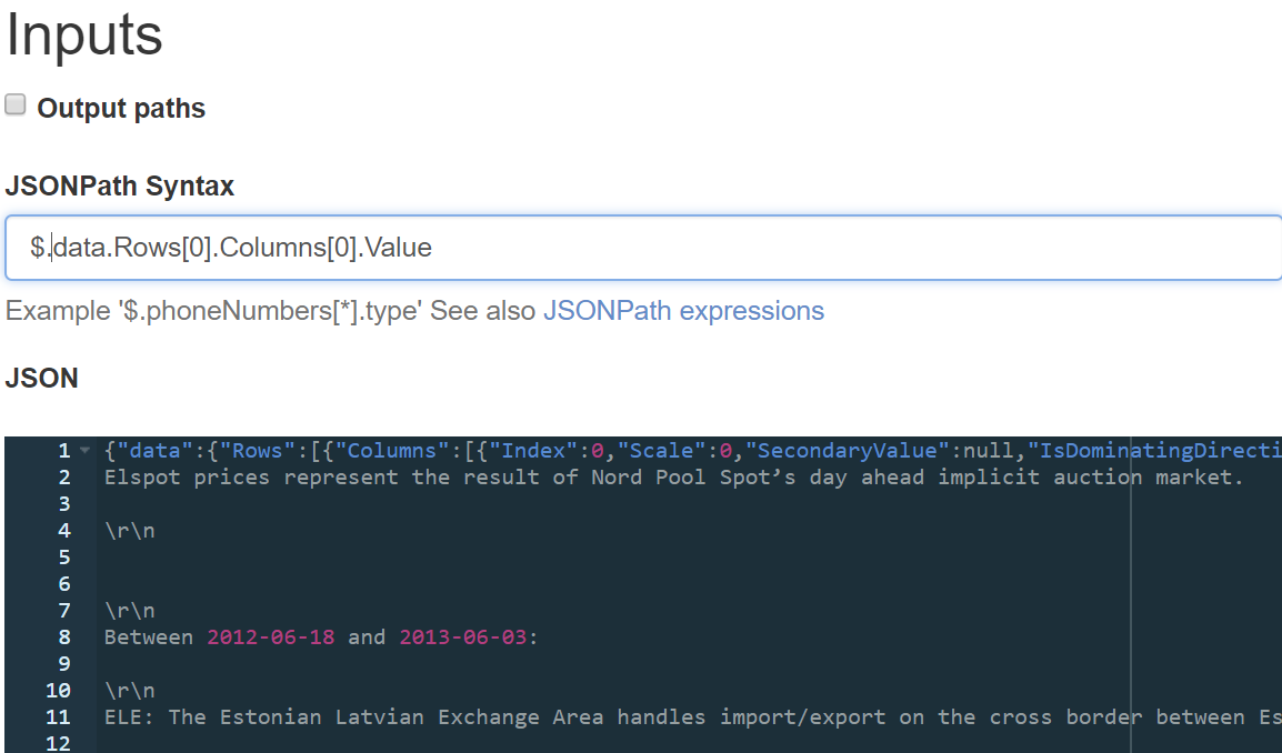

I tested the new parameter in jsonpath.com
It can extract the value, but it is in quotes. So it’s a string?
How can I loose the quotes and convert in to number?
