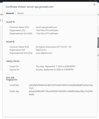

Are you sure that’s what going on? I went to the server-api.growatt.com address and the CN in the cert matches the domain, at least for the 405 error page it brings up.
So they do have a cert with the right CN. Maybe there are parts of the API using the wrong cert? If so they need to know this because it’s going to break everyone, not just openHAB. There’s no point in having the API if no one can use it properly and there’s no point in having the proper cert if they are not going to use it.

The point of the certificate is trust. It ensures that you are talking to who you think you are talking to. It does this by Growatt going to DigiCert (in this case) and proving to them that they are Growatt and that they run server-api.growatt.com. Once DigiCert is satisfied then they sign a certificate that says “yea verily Growatt is a legitimate person or organization and they own server-api.growatt.com”.
We as the clients know that DigiCert has a good process for validating and verifying the identity of people and organizations so if DigiCert signs it, we know we can trust it. But DigiCert is only signing and certifying the Common Name. Just because they signed a cert for server.growatt.com does not have any bearing on whether they own and control server-api.growatt.com.
So the only way you can trust the cert from server.growatt.com for server-api.growatt.com is to not really use the cert at all, which is the same as “trust all certificates” which is basically what you are doing here, just without the warning in the logs.
