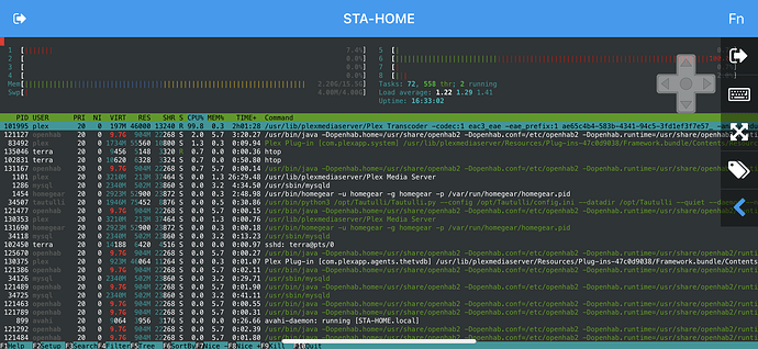

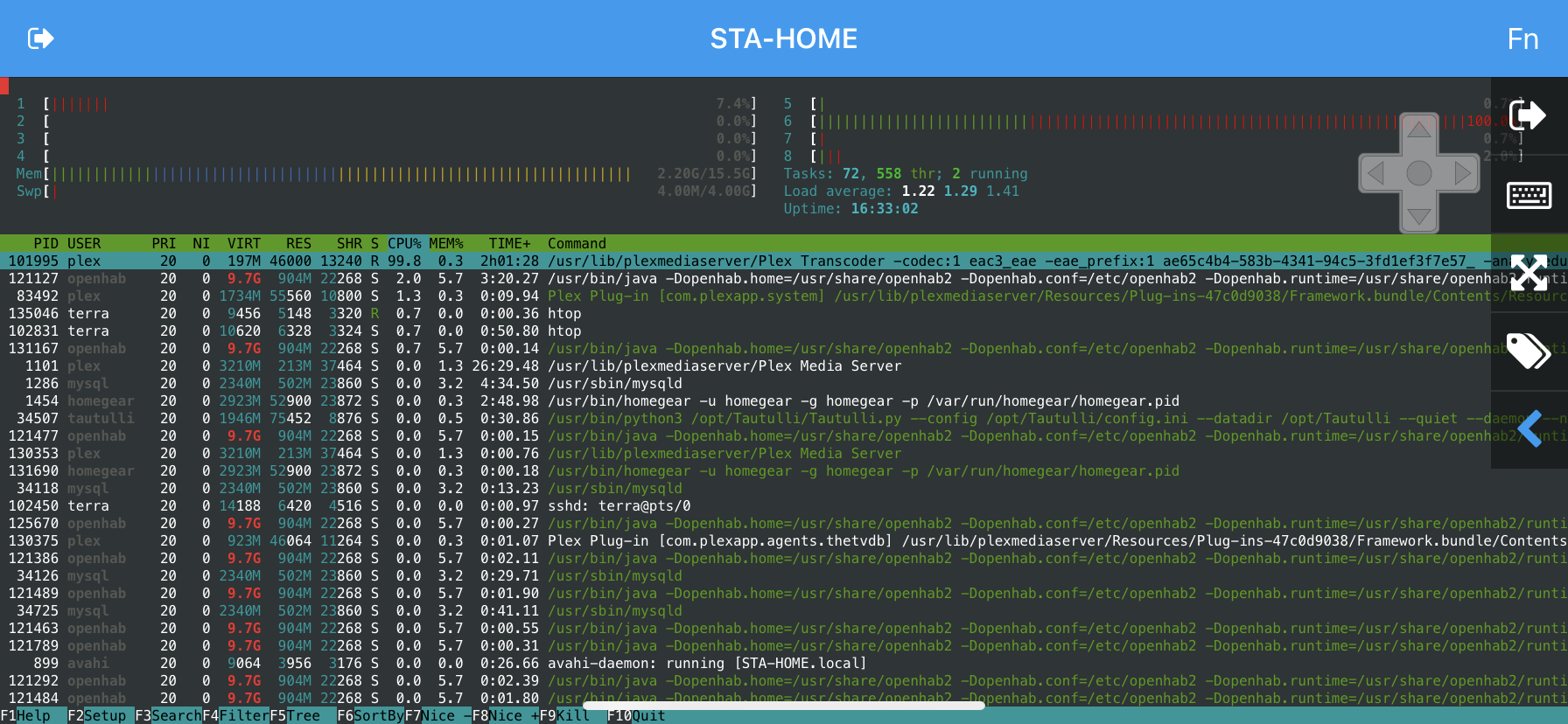

Just watch the top output while doing the action that is delayed, and if the /usr/bin/java (=openHab) process starts using upwards to 100% or more CPUs, there is a hint of trouble.
But, it could also be other processes slowing OH down, and in you screenshot, your Plex process uses so much CPU, 99.8% that that could be the reason for the delays you are seeing.
Try killing it off and see if that helps.
A CPU usage of 100% hogs a core in the CPU. That is why, on multiple core systems, you can see CPU usage of more than 100%. It is usually a sign of trouble if it continues for a long time.
