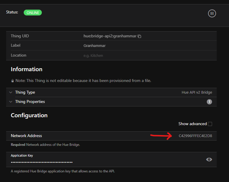

The Hue Bridge Pro starts blinking when I try to add it. The button on the bridge seems unresponsive in relation to pairing.
Any suggestions on what is going wrong here would be highly appreciated.
You cannot use IP address, use the name you added to /etc/hosts file.
Thanks Jussi, yes I saw that and I am already using the ID obtained from discovery.meethue.com so I believe that is not the issue. Any other ideas?
Sorry, misread that you used IP. Did you restart openhab service?
I registered new api key and used that, perhaps you need to do that manually first. I’m not at computer now so cannot give more detailed info how to do it.
Thanks Jussi, highly appreciated - this solved it for me.
For others that may run in to the same issue; obtain the Application Key as described in Get Started - Philips Hue Developer Program before steps 1 to 6 in the guidance above and then add it manually in step 6.
