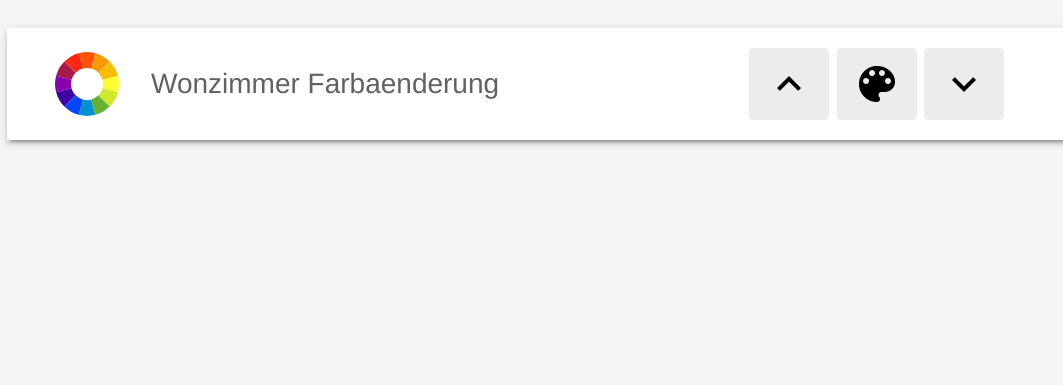

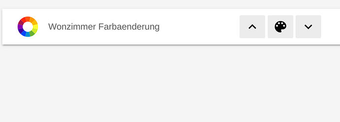

in the main ui i get this
this is working fine so i don’t thing thats related

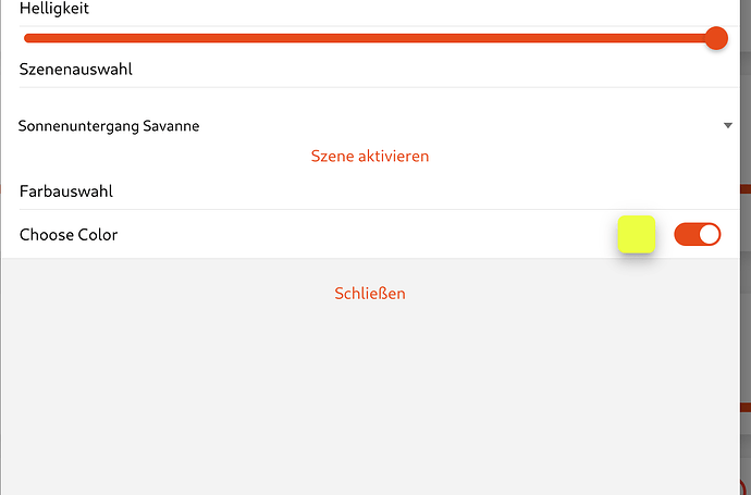

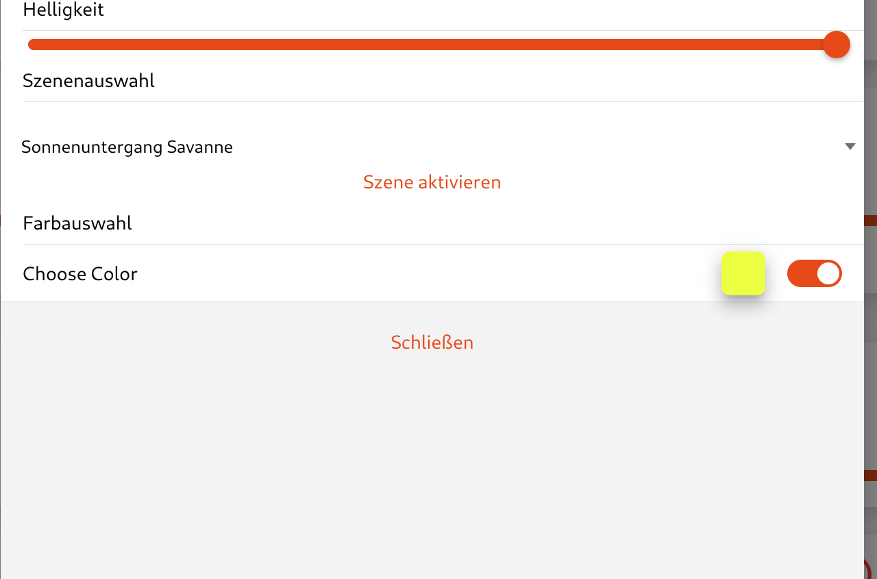

in the widget i can’t click on the color item so I get this
But can’t change it
